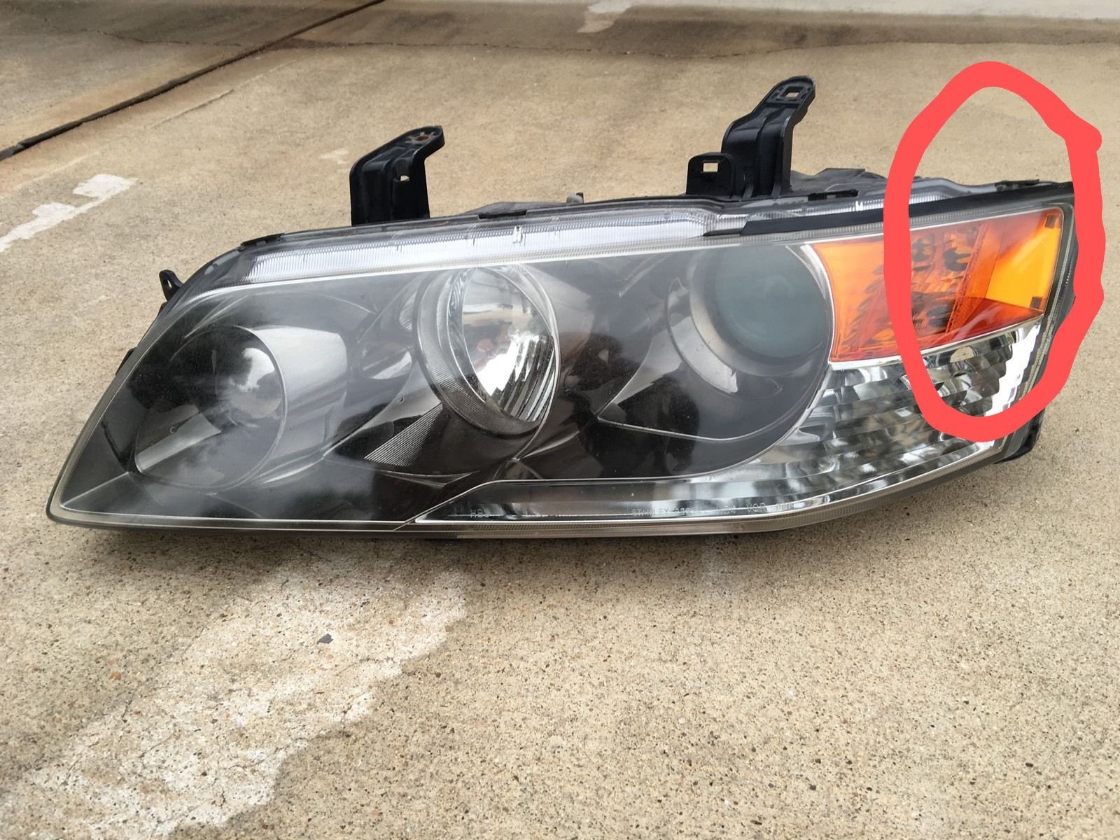

It's not just that there is no DRL. The headlights actually do not meet safety standards. More than the headlight pattern (which they don't check). It doesn't have the side reflectors:
The JDM headlight doesn't have this very small but still important reflector. Same with the JDM rear bumper, which doesn't have the red reflectors for the back. Usdm cars have these things so that's why all you had to do is add a DRL module. Alberta OOP is actually this ****. Same with Quebec. Other provinces are more lax.
Dang, that sucks! Mine is USDM and here in BC they gave me a pile of grief over DRLs. Had to hire Canadian Tire(they are contracted to do OOP) and they hooked relay to high beams then the inspector(same Canuck Junk shop) tried to deny my car. I demanded he show me the letter of the law saying that highs could not function as DRL. He could not so my car passed. Didn't know about the yellow bit, that sucks *****.

My Evo is JDM so they have the righthand drive pointed lights
As far as I can tell from some tuner groups in Sask they didn't have any issues when importing JDM cars and I got the names of a couple of shops to try out.
The taillights didn't pass because they are lacking side reflector that extends past the body of the car so I think I can just wire some small lights and stick them to the side for the inspection
I definitely need to wire in DRLs though to pass.
