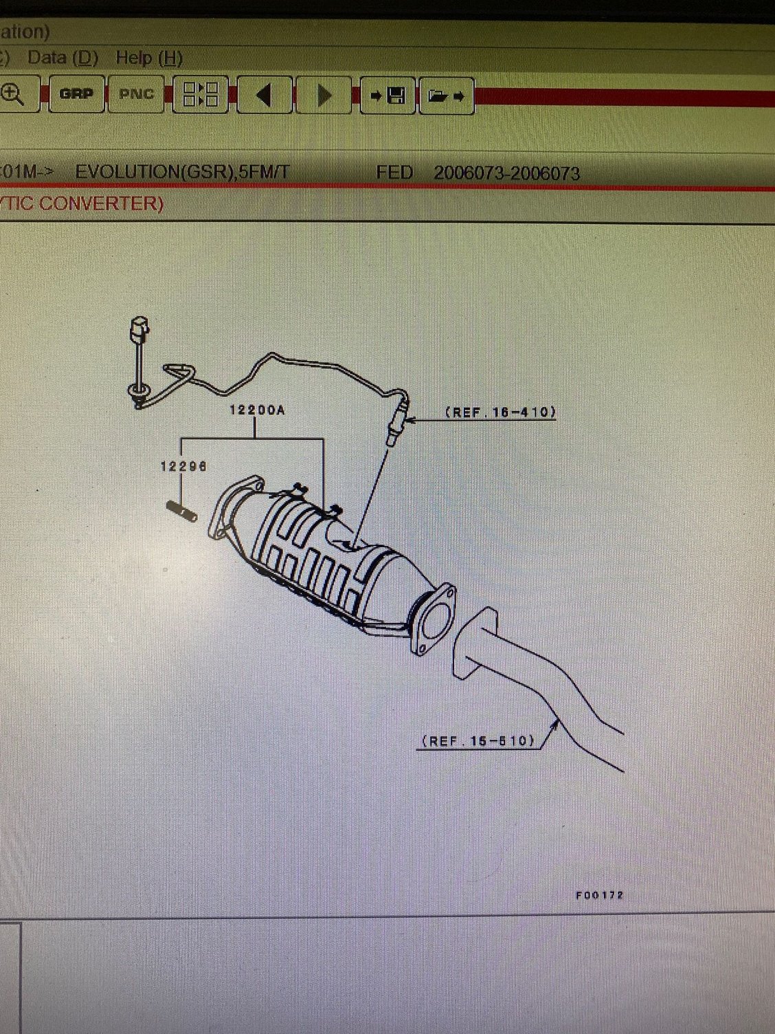

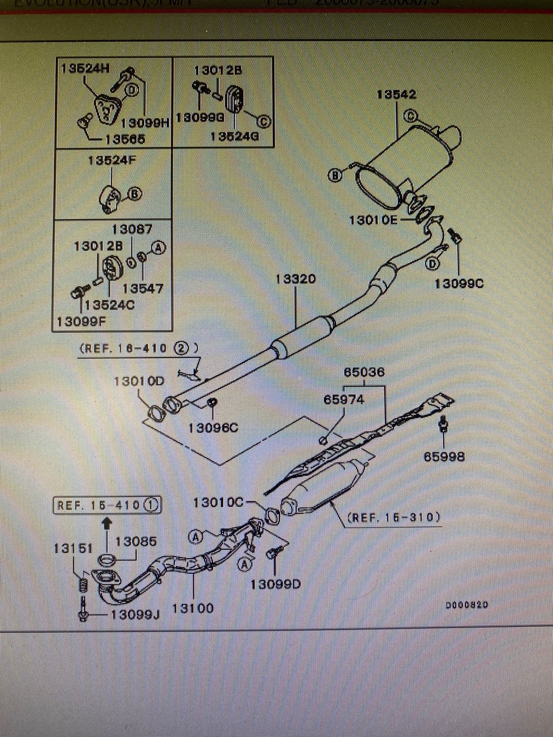

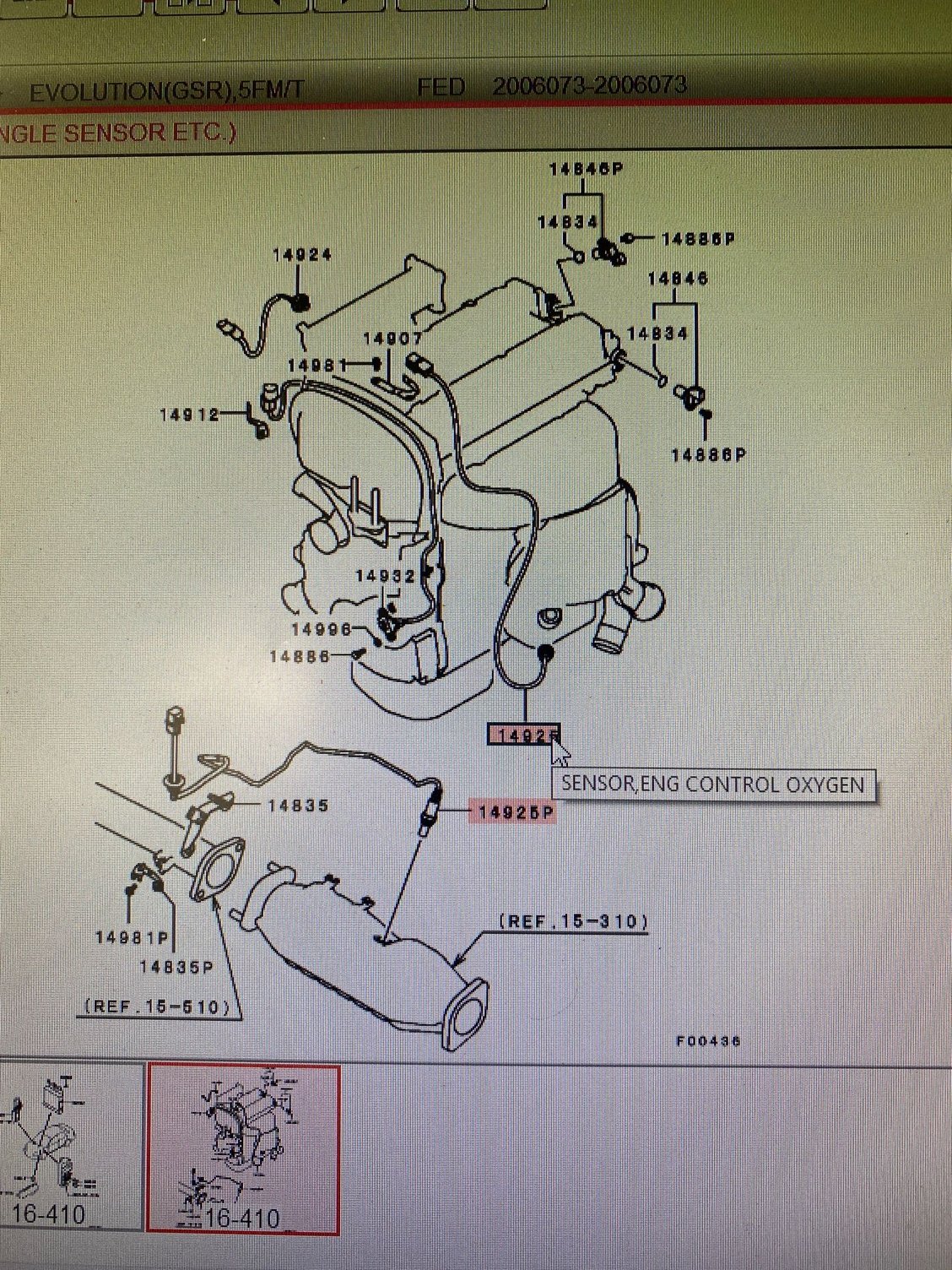

i see. the two guys that did the interview for me and my cousin told us that we need to get it done at a certified automotive repair shop that able to give them proof. They never told us we can do it ourself. If they give you that option than just do it yourself.
my evol came from Wisconsin that's why i get the cross member recall.
Hopefully you get a person that have more knowledge of evol 9 if not.
Another thing print/save these pictures and take it with you to the state referee in case they give you the crap like how our referee dude did to me.
Because on their computer/sources doesnt show them that the o2 sensor go on the catalytic converter on the evol 9.
Once they search on their computer/source it will show that the o2 sensor is behind the catalytic converter.
These pictures i got from the dealer. Bakersfield Mitsubishi dealer.
Also download the files up there post by minus. All of the infor about evol 9 emissions in there.
