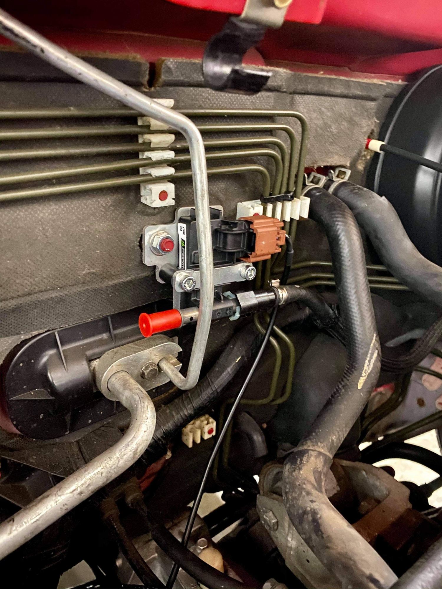

I run the Continental sensor on my 9. Have had it for 2 ish years without an issue.
I mounted mine in the return line behind the intake manifold on the firewall. There was a stud there for AC lines I think that I built a bracket for the sensor off of.

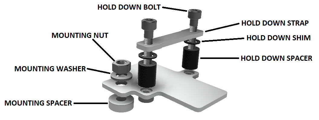

Old Sep 29, 2021 | 09:12 AM
Ayoustin's Avatar
Joined: Jul 2014
Posts: 2,989
Likes: 648
From: SC
I offer brackets that mount the sensor on the firewall, completely bolt on.
