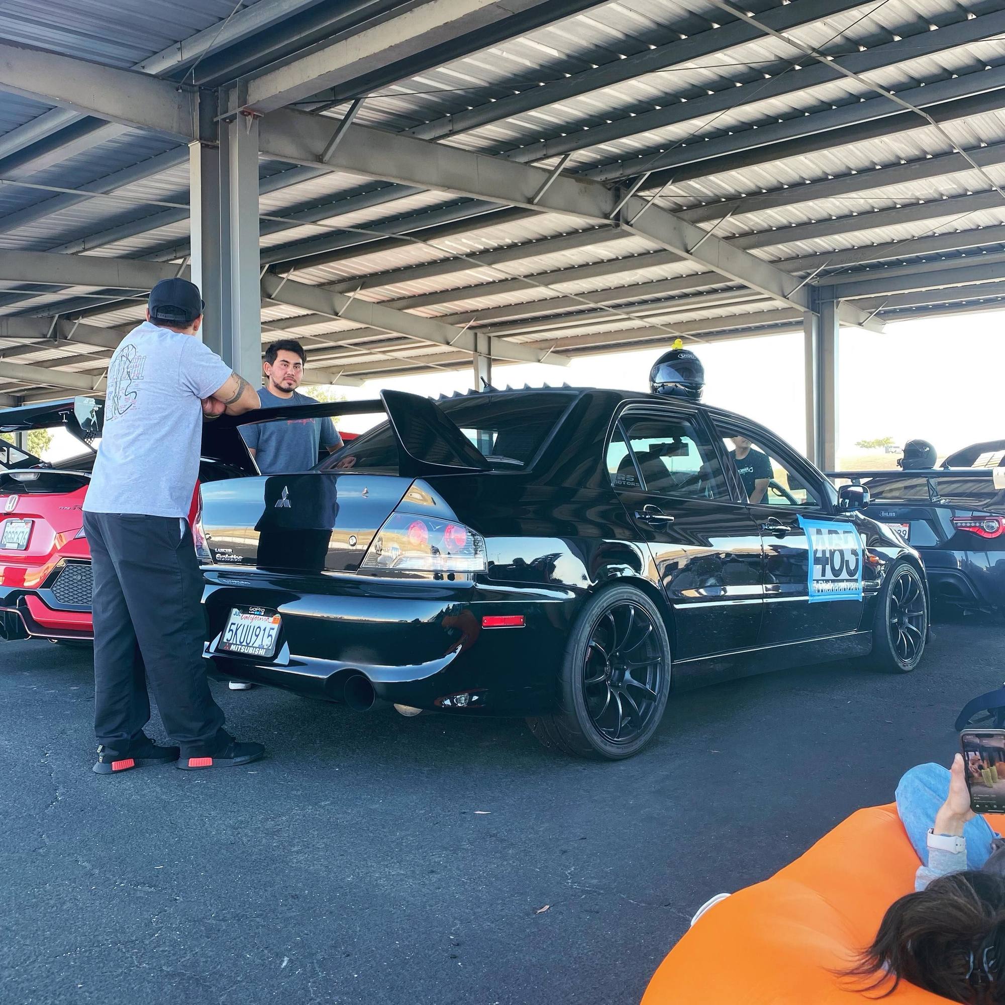

Im not too low i don't believe, im at 13.75F and 13.5R fender to center wheel, with whiteline roll center kit. Having the front uprights to correct suspesion geometry being this low would be nice.

This is pictures of my car, I don't think its too slammed?

My car sits that low, maybe just a half inch for aesthetics. I clear speed bumps but ill get a scrape here and there. Might need to go stiffer on the coil over springs

yup, I noticed your tire looked pinched(more prone to 'ballooning'). in my (nonprofessional) experience +1/2" more wheel width over the maximum 'recommended' wheel width of the tire work best (the RT660 run wider too ). I ran 11" wheels with 285 RT660, 10.5" with 285 RE71R, 11" with 285 RE71RS.
