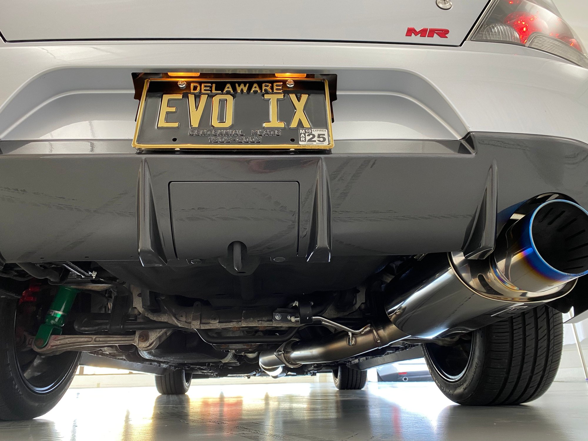

Consult an exhaust shop about modifying the current exhaust. Main reason to get the evo 9 specific exhaust is so you don’t melt the plastic bumper. I got the HKS Super turbo for mine.
