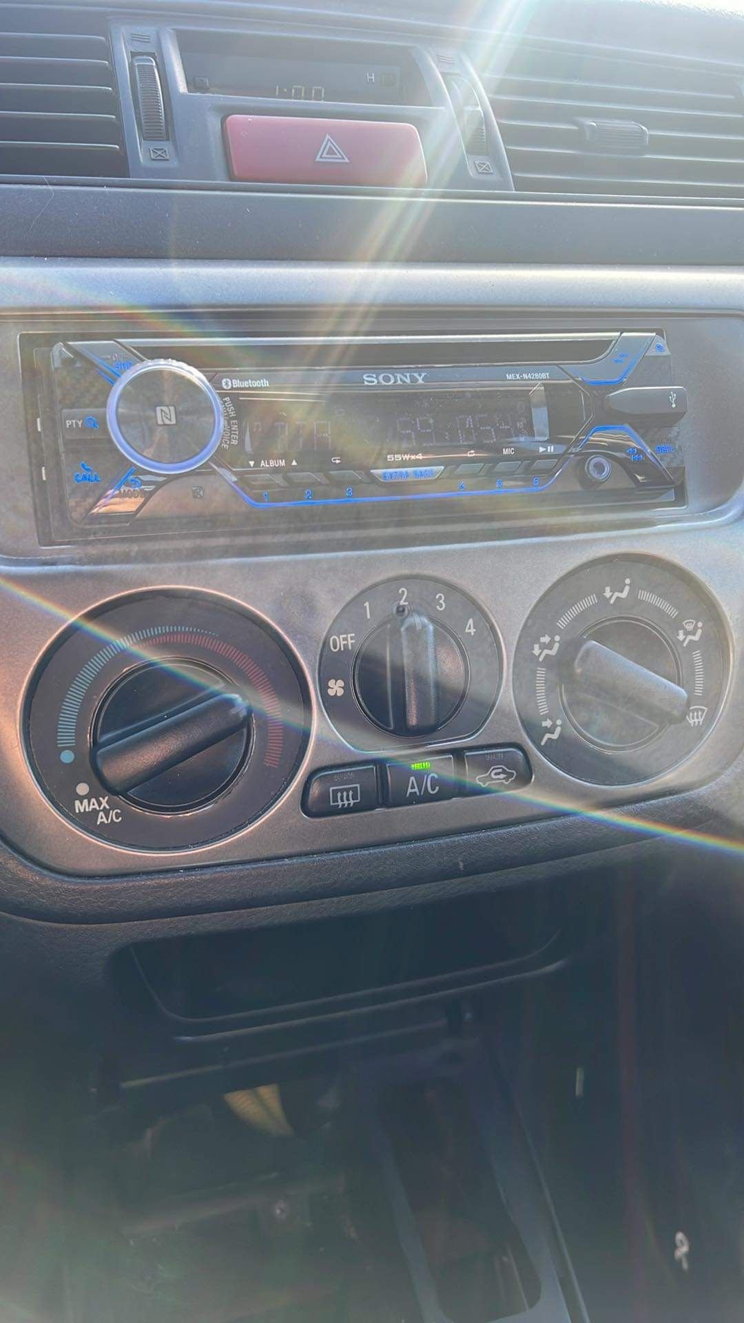

My friend sent me what I was asking about. Temp knob on heat and ac button lights up. For some reason mine doesn’t. Where should I start? Ac works when temp is on max cold only.

Your friend's AC light is on because he has mode dial on defrost. Running the AC compressor helps dry out the air, which helps defrost the windows better.
I understand that, I’m wondering why mine doesn’t turn on with defrost.

if that bothered me I'd check out the bulb or the connector. maybe your headunit knocking something off. if that not it I'd probably buy a used unit from ebay. that button looks generic
the one pictured is my buddies, not mine. He sent me that to show me that his light turns on. I will recheck my connectors but I’m curious as to why mine doesn’t turn on in the same position his is set at. Do you have a picture of what yours looks like?

yeah i know. i mean that button/panel can be replaced with controls from other mitsu cars, if you really want/need to replace it
this hvac control unit came out of a 05 lancer but I’m unsure if it’s correct as the part number said certain year Evo’s and some lancers.
