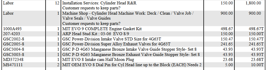

Here is the invoice for the rebuild for reference
