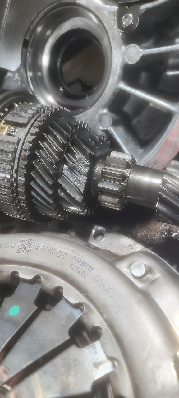

Help where can I get the replacement gears having a hard time finding them and im new to this
See the tooth sheard off

I ship the trans to TRE (teamrip.com) for the rebuild. I also lost the 2nd gear last time

I put the car into reverse it jumped out and I heard a click and i was done ! How did yours happen do you know
How long ago did that happen and what was the cost of the repair and were you happy with the job

mine was in first gear when it popped. i think there was a piece of metal in there that broken off at some point and eventually got in between the gear.
TRE is supposedly the best. his work is definitely better than sheptrans.com, which is also good, without the extra TRE bits.
The price is depending on how good the rest of the trans is and if youre going for a full rebuild. if you want to get it done locally maybe you can contact them for parts

When I contacted TRE last year to inquire about rebuilding my 6 Sp on my 06 he said that he has a good selection of new 6 SP parts in stock. Price can range from ~$2K for a basic build to ~$3K for a full detail and strengthening build.
