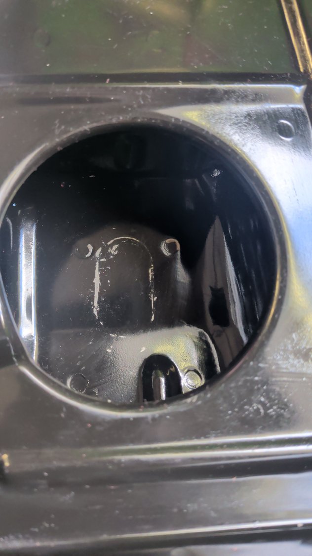

well got the car buttoned up, the front half of it at least, dash forward and took it for a few rounds around the block, getting the driveability sorted, etc...well after the first drive or 2 after pulling back into the lot, i saw the oil light flicker. So i decided to put an OPG on it and the car has low pressure, 20psi on a cold start and about 10psi hot idle.
I just put some fresh 20w50 vr1 in it, the old oil had just idle time didn't see anything concerning and the car isn't making any sort of noise but something def isn't right. Maybe a bad pump, loose pickup or bad clearances...so the next step will be to pull the pan and take a look to see if something obvious is going on or not.

After changing oil to 20w50, comp test and doing maintenance, it had no pcv setup and no catchcan so i hooked pcv back up, verified with 2 diff gauges but it seems like oil press even on a cold start doesn't get above 20+ psi according to my aem oil press gauge, mounted off my oil pump. Motor sounds fine, old oil looked fine, no obvious shavings or glitter.. hot idle is like 10-11ish psi. I"m thinking the best course of action would be to drop pan, check rods? faulty pump(unlikely im guessing) stuffed pickup? i drove the car probably like 10 miles in the process of making it in a driveable car. Once i verified with my OPG that pressure was too low i parked it.

So I did a few things, unfortunately still seeing the same issue.
Pulled the filter, cut it open. Looked fine. Keep in mind fresh oil and filter had only 12 miles on it.
Oil looked fine as well, some metallic shimmer but the engine looks brand new, i think its mostly from new break-in. Somoene mentioned balance shaft delete and bearings could be the culprit but they are still in place.
Dropped the pan, didn't see any bearing material. However it did look like the pickup at some point was touching the bottom of the pan. This seemed like the smoking gun, I could see the outline of the pickup on the pan. Straigntned the pan out, put some grease on the pickup to ensure it wasnt touching the bottom of the pan and it passed the test.
put it all back together, on a cold start with 15w40 it still showing me 20ish PSI of pressure. After it warmed up i gave it a few revs, 2k rpms gave me ~18 psi but 3k rpm holding the revs gave me like 23psi of pressure.
Leaving me with 2 places to go to next. Either a faulty aem oil pressure sensor or a bad potential pump? I guess the next time I yank the pan, ill check the rods and plastigage them to see what clearances are like. Open to ideas and suggestions.

I have the aem brass fitting mounted to where the oil pressure switch threads into at the rear of the block. I'm going to screw a mechanical gauge on the oil pressure housing, which is where I had it before when i previously tested with the mechanical gauge.

Cold start pressure shows about 30psi with 15w40 oil with fitting at OFH. Strange thing is with the car warmed up, with a steady idle the pressure fluctuates between 12-20psi...at this point im just gonna yank the motor and send it to the machine shop to get it clearanced and see what the mains look like. I was going to do it myself, but id rather not screw around and just get it done proper, if thats whats needed. Have a new pump on hand ill throw on when its all back together.
With that being said, are there any restrictors or anything of the sort in the head/block that regulate oil flow? I know on 6g72's theres restrictors in the head, that help to regulate pressure, just want to make sure with the big items being addressed(bearings/pump/clerances) I dont miss anything in the details.
