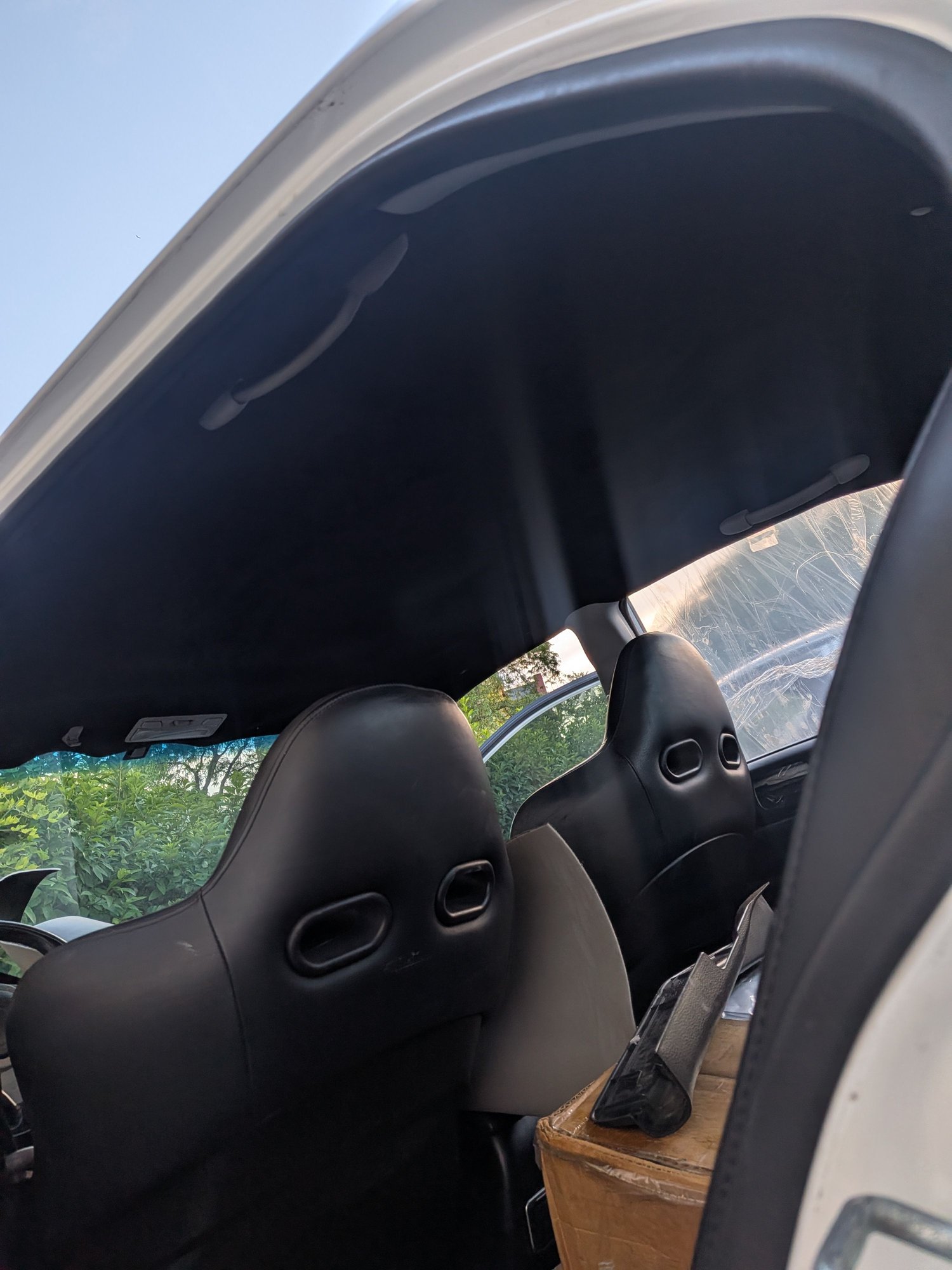

Found out I couldn't install the generator w/out an anteanna base so ordered one from the junkyard. Should have it this week.

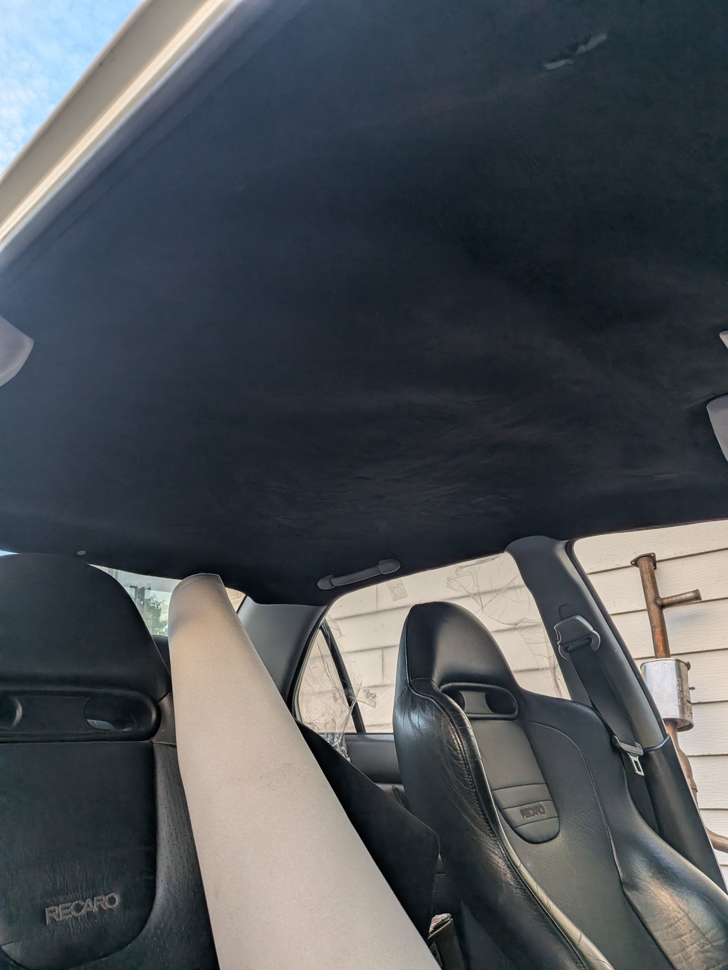

In the meantime, finished the headliner. Its not my best work, but should keep things looking tidy for a while. If it starts to droop, ill look into having it professionally fixed.
Once that was done, i shifted my efforts to getting my headlamp sealed. It was in sad shape, especially the driver side. It wasn't even sealed, previous owner did a sloppy job painting the lens flat black. I just wanted to finish his loose ends. Removed it from the car, disassembled it, cleaned the lens on the inside and had my brother polish the outside lens. Then i resealed it. Looks much better than before. Even the after picture looks terrible, i just took a bad picture, ill post another one once i get the bumper on, which im aiming for this weekend. Fan control module seems to have crapped the bed have a replacment coming from amazon this weekend.

Moving along in my list of things to do..
headliner is from a sunroof car, convert it to non-sunroof, cover with alcantera and remount-DONE
properly install interior a-pillar trims-DONE
install new lugnuts-DONE
mount wbo2 sensor and wire into ecu
install anteanna/vortex generator
install drip molding with new clips
wire fans properly-WIP
purchase new mats
purchase and install underbody tray
mount front bumper
refinish front headlamp lenses-DONE
once i do some hwy driving and no vibrations present, mount centercaps on wheels
rebuild throttle body seals
final tune

Headliner looks good. I hope to do it this winter.
