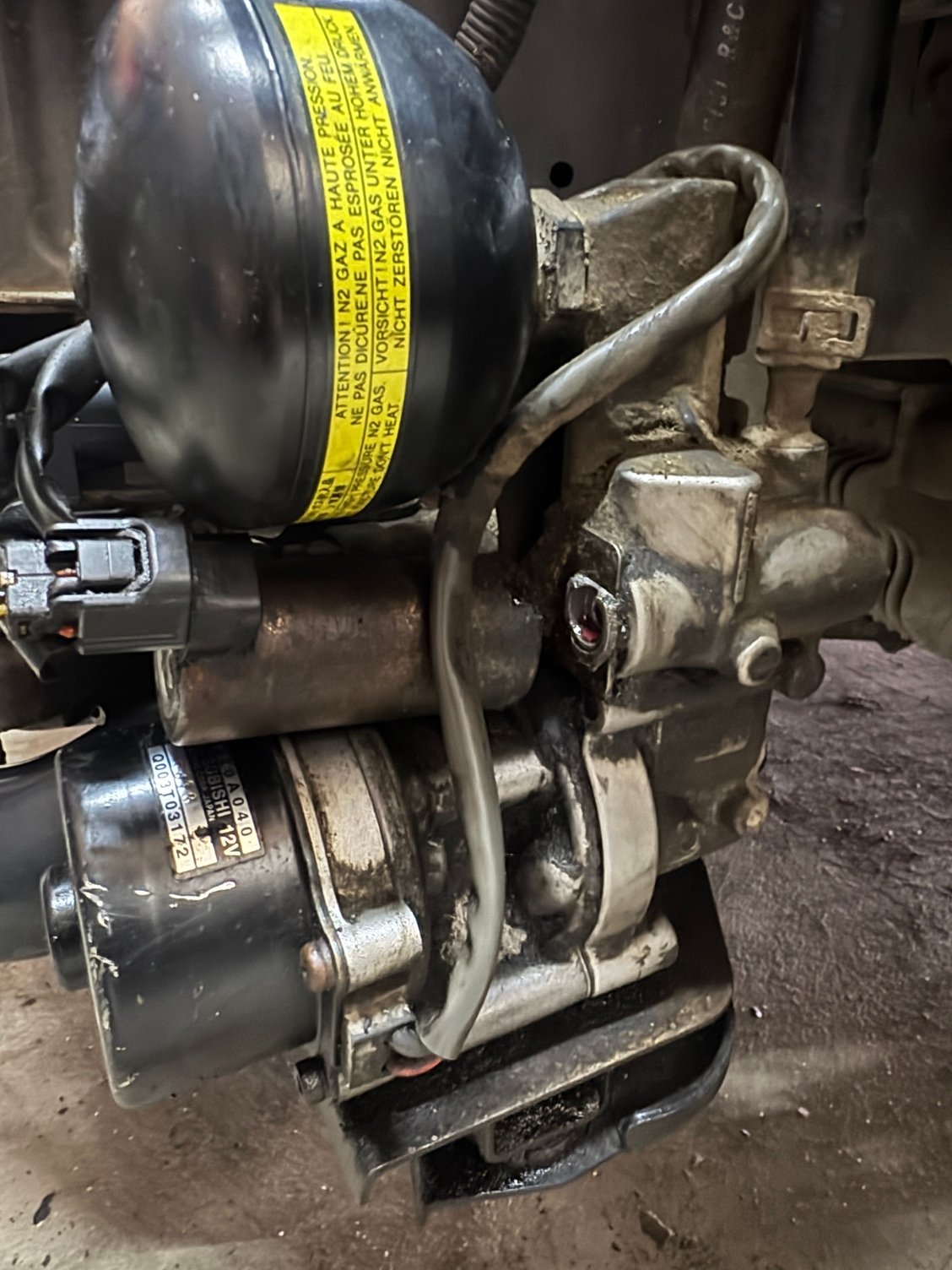

Sadly, My Evo got hit in the left front corner by an oblivious soccer mom and now I need to limp the car a decent way to get it to an adjuster and body shop (I live in a remote area). Anybody have advice for driving with a broken ACD pump? Can I tape over the openings, fill it with diff fluid and hope for the best?

That's the solenoid that got broken there so I suspect if you unplug the pump so it doesn't try to pressure up you should be able to limp it to safety.

take the pump off, cover the connectors and hydraulic lines so that they do not get dirt inside and drive normally. No need to add oil anywhere. Car will understeer more on the limit.
Just unplug the electrical connector nearest the solenoid?
To the pump itself so it gets no pwer.
And start your solenoid/pump quest now. Solenoid is really hard to find, I got mine from Russia years ago but that route is currently unavailable.
