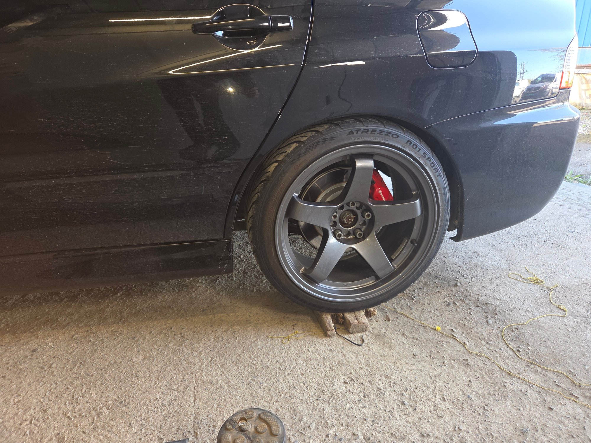

Hello,
As title says, the one rear side of my car is noticably lower than the other side. Approx 1,5 cm (0,6inch). And is even making wear marks to my tire because my fender is touching the tire in corners and such.
I have tried changing suspension, but have the same problem with oem bilstein as i am with the öhlins r&t which im on now.
I cant see any bent parts. I have also tried cross measuring to see if anything is bent. With no luck so far.
Had my car to get alignment today, but they could not get the rear right because of this.
Does anyone have suggestions on what i should check/try? I got my own 2 post lift.
Thanks!

I have noticed now. After having my car on the lift for some days, and then putting it down, the car seems the correct level on both sides. Altough after driving with it the one side sits lower again...
Does this help me find the problem
