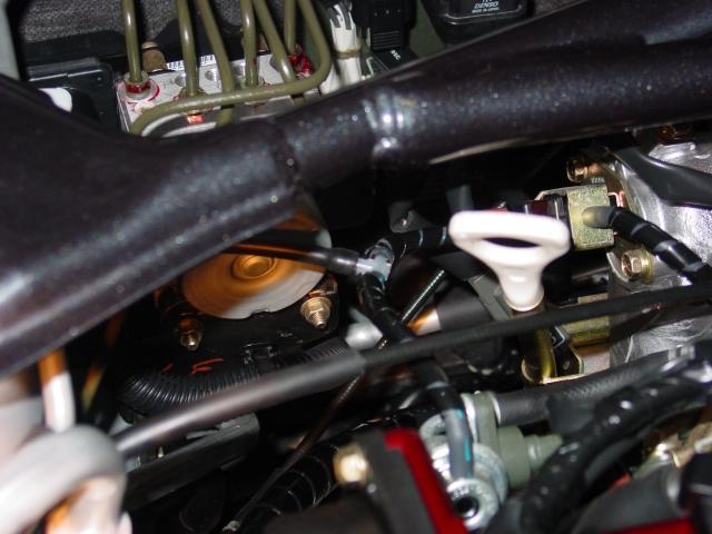

so.... which is the correct way?
is this right or is it supposed to go to the one next to that.
somebody please straighten this out for me. there are two different write ups i read and they are different. Is the write up on evolutionm the correct one? (I believe it was posted by IAMHUNG)

most people (and me) use the shorter hose, immediately to the right of the dip stick handle in that picture.

is there anything wrong with connecting it to the longer hose runing from the fuel pressure reg. thats where I taped mine. it seems to be doing perfect.

It will work but you might get fluctuations from the FPR.

Both are ok. Just one isnt as accurate. I had tapped into the one closest to the dipstick and when revved it in neutral it would say i was boosting 10psi. I changed it to the hose one up from the dipstick and its been perfect.

The FPR line has been known to make the boost gauge "stick" if you drive the car, turn it off, then turn it back on again shortly after and drive it again.

should I look into replacing the line running to the fuel pressure reg. and tap into the one listed above. thanks for the help. I haven't had any problems with it. my car will also reach around 10psi if I rev the engine in neutral, but the car is building boost because my bov blows off.

the factory gauge taps off the BOV line.

I dont think its a big deal. Thats how they were tapped in on the 1g and 2gs. There shouldnt be boost building up in neutral, atleast i dont believe. When you tap the other line, you can revv it as high and as long as you want and it wont go past 0. You could just switch the hoses, i believe(its what i did). Instead of having to get new hoses.

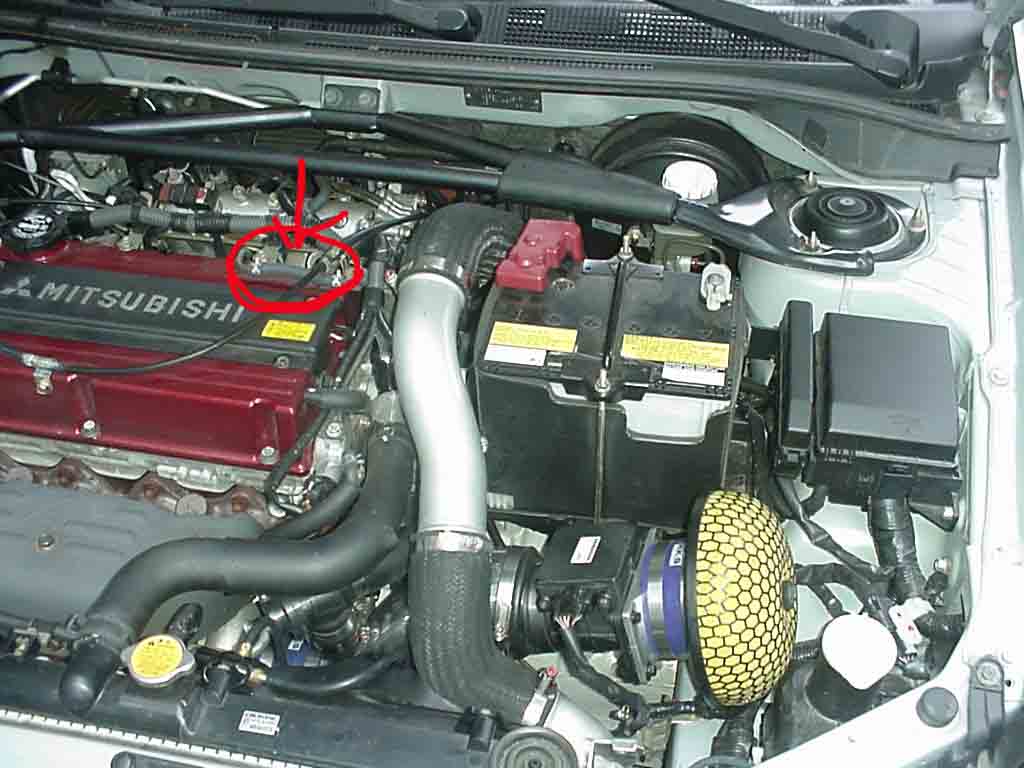

iv been told this is the best place or on this line
iv been told this is the best / most accurate place to tap into because it does not get changed when ur air fuel gets changed up. Malibujack helped me out with my avcr last week and helped me get a mor accurate reading at the same time.
hope this pic helps
sorry for the dirty engin compartment somone coff coff blackevovii doesnt wash his car. Ha

Hey I took that pict! Works perfect for me!
You will build a bit of boost if you rev in neutral. but 10# lol yea thats not right.
