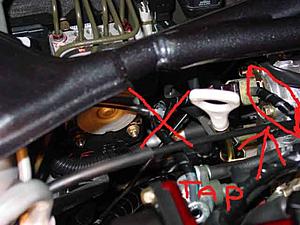

I dont think the hose would make a difference. Its your tap. You could either try the next hose up or the hose that is in the picture on the bottom of page 1.

you see the picture i posted? tap into that line their if ur hose is long enough if not . the second from the left hose on the throtle bodie i belve it has a blue dashed line on it. ( could be wrong on color ) is the one u want the one a little further away from the dipstick.

working on editing ur picture ill circle where u want to tap if ur line isnt long enough for the place i have
Ummm, if youre going to edit my picture, you could at least say that both spots will work fine. It makes it look like one way is wrong vs another
Gang a boost gauge only messures pressure inside youre vaccum hoses. Almost any vaccum line will work.
His readings on the boost gauge sound like a result of him pulling the pill out of the wastegate line. That's why he's holding boost to redline where ours tapers off.

well ur tryn to get the most accurate reading possable. both of thoes do work as i stated earlyr and i did say that in the post. dont mean to make ur pic look bad its just a color that stands out and i dont want to be giveing incorrect info but for a better place to tap where the a/f ratio doesnt get changed as it does or could the best place to tap as iv been told by malabuejack ( sorry if iv spelt any thing wrong ) is the vacume line on my first picture where i also have it circled in red if ur vacume hose can reach. if not the best of thoes two vacume lines is the second one where i have circled.
ps
both spots dont allways work fine. they might work but will not allways show correct boost / vacume
