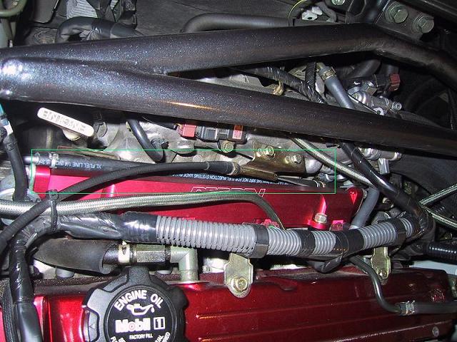

You don't need to re-install the gold metal fuel return line. See the pic attached, I used the hose that Perrin included in the kit...
I don't know if this is by accident or whatnot, but the item "boxed" in this photo is the throttle cable. Did you happen to mean the braided line also depicted in this photo?

pretty sure he is talking about the one right above the rail right under the throttle cable gotta look close to c it......

It's under the throttle cable. I knew what he was pointing out.

I understand you might, but someone unsuspecting might not.. Just thought I'd point that out. No biggie.
