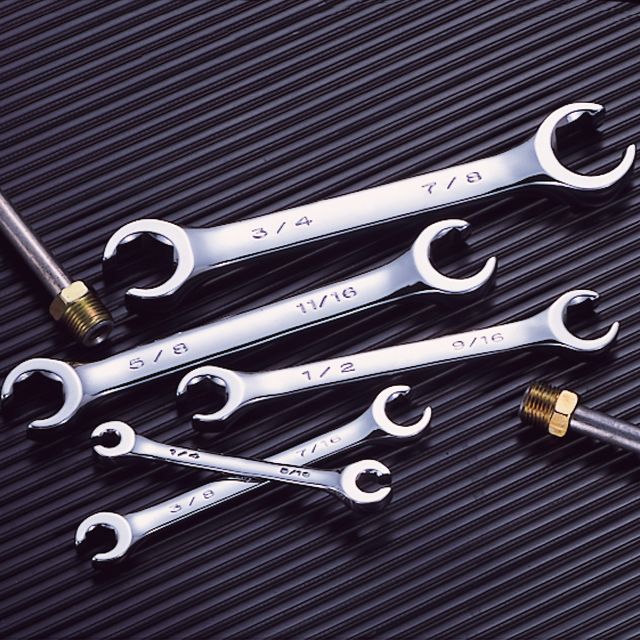

Realize this is an old thread, just wanted to add some more useful info for the guys with MRs.
For the Evo 8/9 MR Trace the wire back about 12 inches from where it comes out of the oil plug and there is a clip you can disconnect. Do that, and then slide a box wrench over it and unscrew the drain plug. I used a 19mm box wrench.
Or.....You could also use a flarenut wrench like the picture below. This will allow you to remove the oil drain plug without disconnecting the wire. I wasn't able to find one in 19mm at my local autoparts store, otherwise I would have done it this way.
