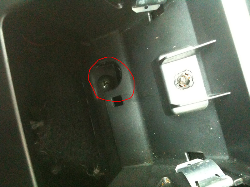

Open up the ashtray and pull it out. This will expose another screw for you to remove.
Attachment 339480

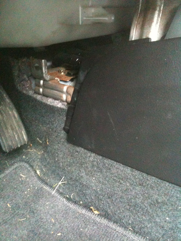

Okay, now you get to open the door and sit on the ground on your knees. Take a peek down on the ground near the gas pedal. Remove that plastic phillips screw.
Attachment 339482
After the screw is removed, remove that whole plastic piece. This is what you'll see after its removed.

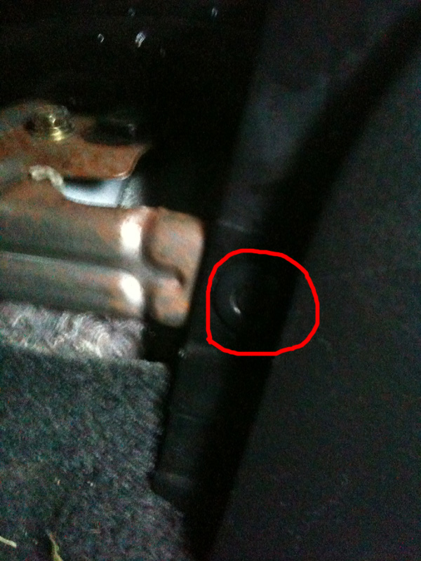

Look close and you'll see a plastic push pin. Take your phillips screw driver and press in the center of it. The whole piece should then pull out.
Attachment 339484

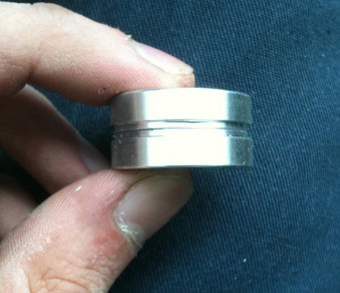

BR gives you 8 pieces. 2 per mount. One goes on top of the other like so.
Attachment 339476
The bushing should hug the plastic assembly. I found it easiest to do the 2 front bushings before the rear. Slide the bottom bushing into place, lower the shifter assembly onto it, set the top bushing over it, insert the 12mm bolt and thread it in just a couple turns. Leaving it loose makes it much easier to install the others.
