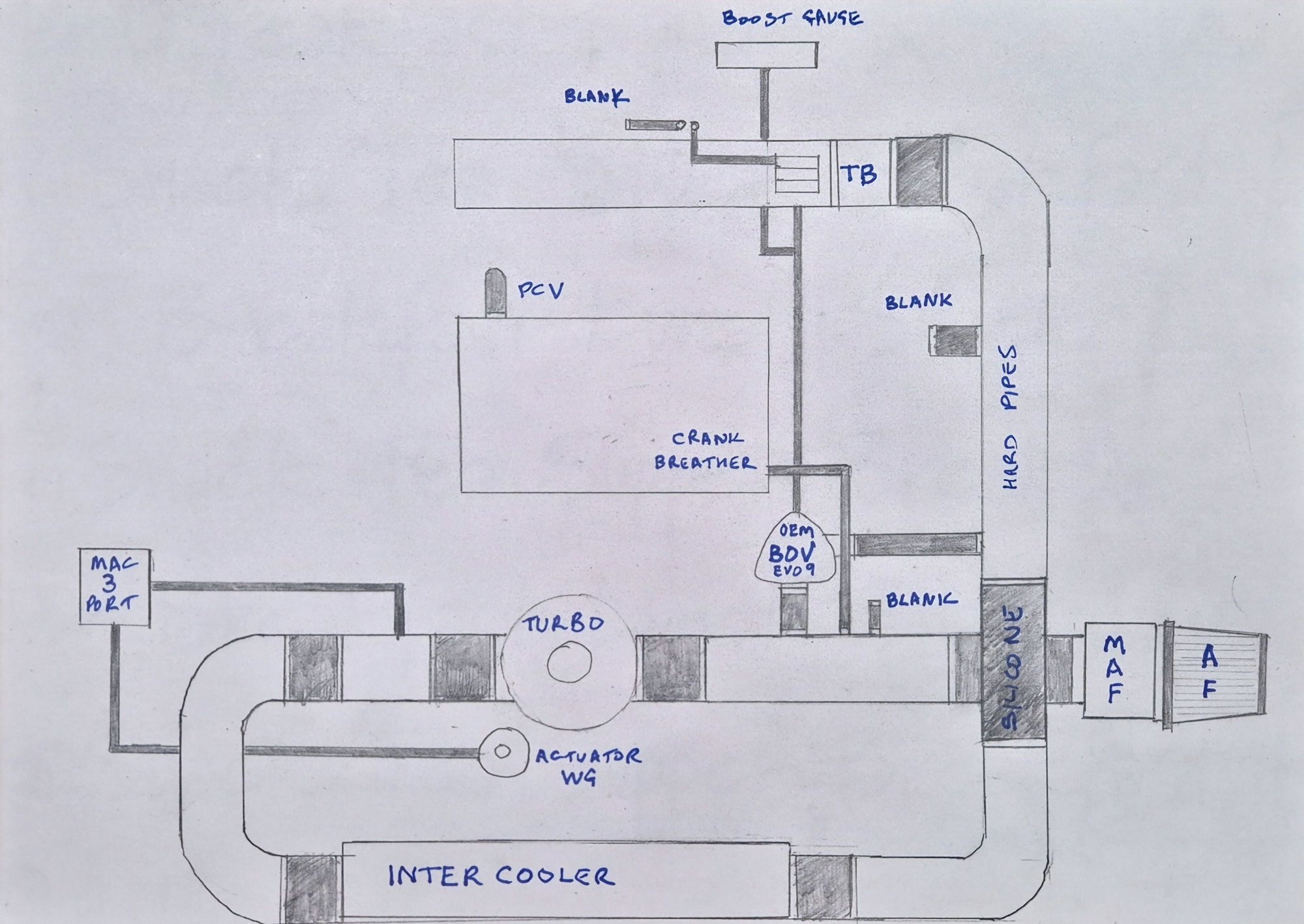

Hi guys,
I have an Evo 8 mr. And it is overboosting, as such i am trying to do a boost leak test.
I have purchased a VXSCAN V4 smoke detector.
My pipe work is set up as follows:
I have read various threads and everyone says something different.
Now I disconnected the BOV from the intake pipe and left it open. I removed the intake, maf, air filter and hard pipe leaving just the silicone connector on the turbo.
I then hooked up the V4 smoke machine at the turbo inlet.
I removed the crank case breather hose leaving the breather open.
I then used the V4 to put smoke into the turbo inlet and began checking for leaks. I initially started at 1psi, and then went up to 2 psi.
I couldn't see any leaks anywhere and the onlyvsmoke visiblw was coming out of the crank case breather.
I tried to turn the air pressure up, the V4 machine will max out at 20psi, however it didn't seem to want to go above 3.3psi. I am not sure if this is because the crank case breather is open or some other reason.
Can anyone give mesole advice of what to do. I dont have access to an air line, just the V4 built in pump.
