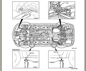

can someone post pics of front and rear jacking points that can use floor jacks and also places to place jack stands? thanks.

Do a search, plenty of info here. I found a diagram on here showing the jack points.
The front lift point is under the front access cover. If you take that plastic cover off, there is a tow hook and a very sturdy place for your floor jack. The rear is under the diff. Jackstands could go under the jacking points as shown in the owners manual. I use jackstand with hockey pugs to protect the metal, but someone here also has a link to special nylon covers with groves cut into them that fit over the jackstands.

i searched but found no pics. one of them used to have pics, but they're gone now.

damn i knew i should have saved the picture in my comp...anyone have it?
You mean this one?
Attached Thumbnails Jacking Points with a Floor Jack-evo8-jack-points_evom.jpg

thanks very much!
