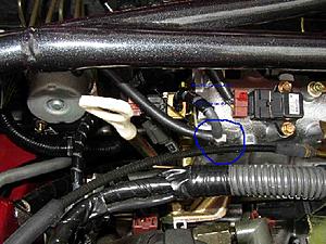

where to T
this may help . i Tee off the top one and just used a new shorter piece so you dont have to cut anything.

yeah its over there almost next to the fender area, i used a long piece of thread all , and pushed it out form the inside you cannot push it in from under the hood it is a one way rubber mount. you will need to take the glove box down then look way over in the corner and up. mine was covered in white power so use a bright light very nice and clean , hard part will be trying to put it back later , someone with small hands or twisted coat wire maybe.
