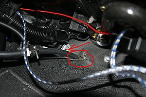

Screw that stupid rubber grommet. I worked my *** off trying to get some lines through that thing. The easy (and much quicker) route is to drill a hold in the firewall. See the two attached pictures. One is under the glove box and the other is inside the engine bay. Line yourself up with a bolt as shown by the arrow on both pics so you dont drill into your anti lock brake tuging. The 03 evo is shown and I have no idea what the 04's and 05's look like so do so at your own risk.
The firewall is two sheets of steel or aluminum with rubber sandwiched in between. So don't freak out when you break through the first sheet and find you still have more to go... Watch the insulation as it binds up in the drill when you start and when you break through into the engine bay and pretty much any time it touches the drill bit. Never tried the fender route as I never had anything going that way. Patch it up with some silicon if your hole is much bigger that what you pass through.
