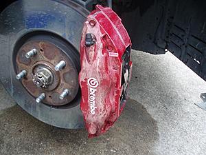

2. This is my caliper before anything has been done to it. That's nasty.

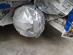

6. After you have done a couple light sandings and have covered the area pretty well, you're ready to paint. Make sure you cover the bleeder valve (I don't have it covered in the pic).
7. This is after the first light coat. Make sure the paint is dry (after about 10-20 minutes depending on how heavy your coat was) and look around for any blemishes. As you can see I found some and sanded them down. Clean the caliper off again and you’re ready for another coat. Repeat this process until you’re satisfied with your results.

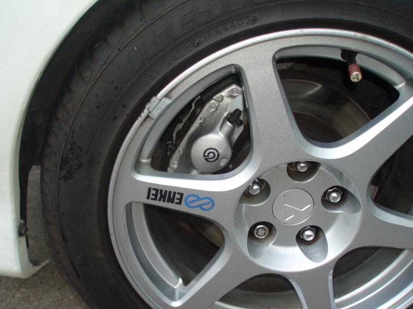

I don't have anything else to tell you guys about painting the calipers I just wanted to post a couple pics of the finished product. Good luck to everyone that tries this out!
