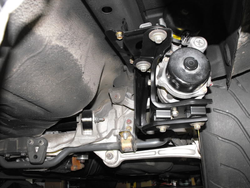

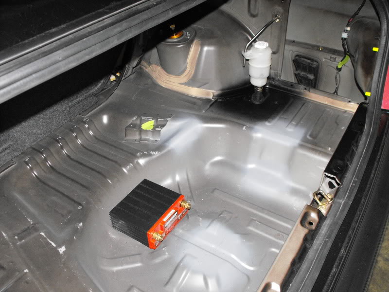

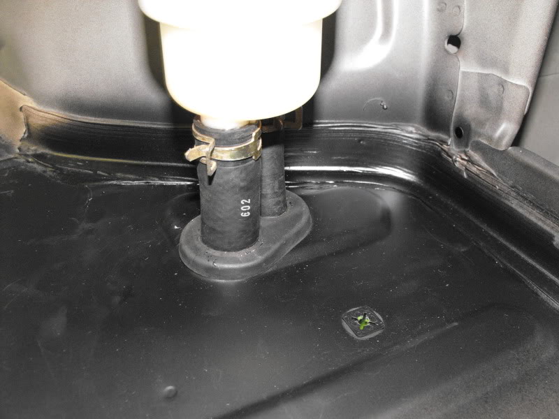

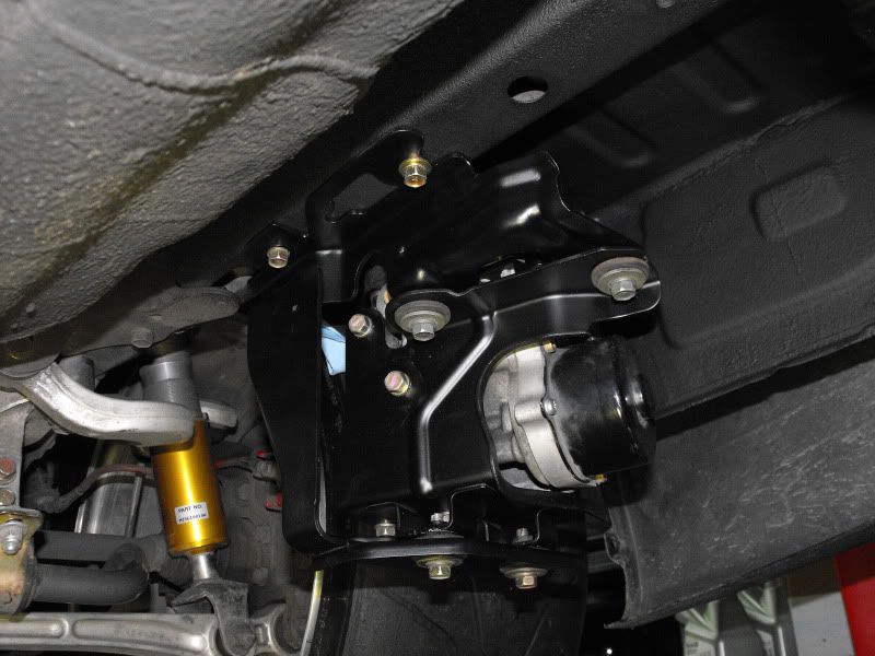

I need to route the hardline and fittings to the ACD now. I'll work on that this coming week.
I'm trying to decide whether i want a lower CG or a slightly better L-R balance. I think I'm going with option 1
Option 1
Option 2

Cool idea but why not put the whole thing in the trunk. That seems to me like just a better balanced (L-R weight) high risk area. Is there somwhere behind the rear diff that it could mount? I havent looked but it would be able to be cooled and protected without having the rear wheels flinging crap at it if its closer to centerline of the car.
Old Jan 30, 2012 | 02:33 PM
R/TErnie's Avatar
iTrader: (32)
Posts: 5,380
From: WAR EAGLE!
I've got a carbon fiber shield for it. Just no pictures yet.
Because improving the CoG is just as important as tire sensitivity. No reason to place it higher than it already sits.
