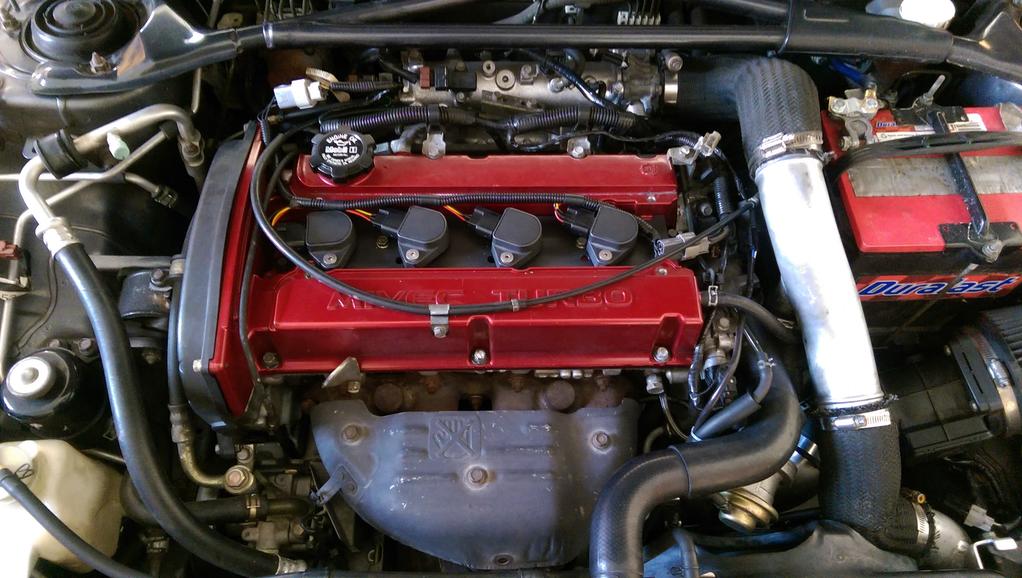

try pulling them through with needle-nose pliers
Old Mar 4, 2015 | 06:48 PM
  #422
tsitalon1's Avatar
Posts: 2,072
From: Southeast USA
Tried that as well...seemed like I could actually pull them past the point where it's supposed to catch.
Guess I'll reorder the connectors with the pigtails already on it
Old Mar 5, 2015 | 07:36 AM
  #423
llDemonll's Avatar
iTrader: (21)
Joined: Jan 2011
Posts: 3,231
Likes: 99
From: Washington
post a picture of the terminal and how it's crimped. and look down the connector to make sure the latch is still in there
Old Mar 5, 2015 | 09:44 AM
  #424
tsitalon1's Avatar
Posts: 2,072
From: Southeast USA
The Honda coil connectors/pins worked flawlessly!
I'm not sure what happened with the Mitsu ones, it appears the plastic catch is not seating all the way in the terminal.
I've ordered new ones with the pigtail on them so I can just move on, I know when I'm beat
Thanks Stevo.
Old Mar 16, 2015 | 04:23 PM
  #425
tsitalon1's Avatar
Posts: 2,072
From: Southeast USA
Finally got it together, car runs great!
Thanks to everyone for the info and help!
