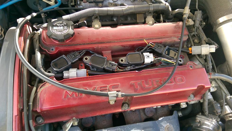

Wired mine up today using this write up. Turned out pretty nice!

Impressed with results car feels more responsive in the lower Rom range. Worth doing this mod.
What coils and connectors did you use?

Not sure exactly but looks like Honda coils and connectors

So what Coils are best to just mount to the stock holes? So you dont need to make an alternative mounting plate? I dont want to have the hole to the spark plugs open :/
I doubt there's any that will cover the hole. I used the Toyota coils that fit under the stock cover. And even those don't seal up the hole. Now I gotta come up with a way to seal the hole so dirt and other things don't go in there. The question is how?

None, you need to make a mounting plate no matter what coils you get. Best to mount in stock holes are the stock coils

Anyone figure out a way to stop dirt from getting in the holes?

use the rubber boots that come with the coils you purchase
