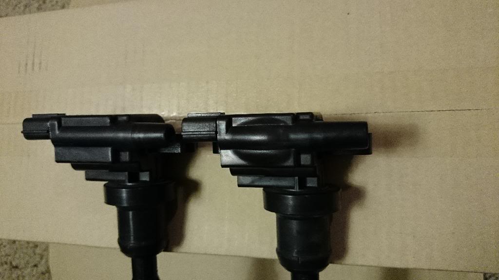

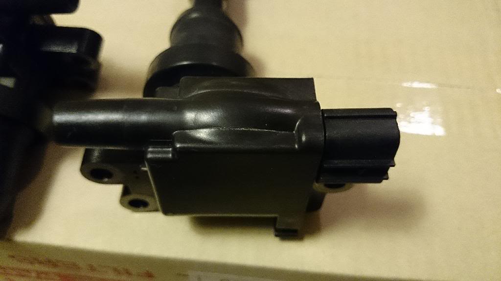

I'm using the plate that comes in the DIY kit from Spoolin' Up. The part number on the coils is 90919-02240. All connections were soldered as good practice with any wiring. The fact that the COP kit is having misfires is only a partial concern at this point - I'm mainly bewildered & getting irritated right about now on why the engine isn't accepting the original ignition system back, & is not idling smoothly with the stock coils.. I tried putting the stock coils back on tonight, idle ran rough for under 2 minutes, & the inside coil that is for cylinders 2 & 3 got smoked! I put the COP coils back on, & what do you know - purrs like a kitten!
The coil on the right with the bubbled side is the smoked one. The closeup that shows the body split open had smoke coming out of it when the engine was idling for those 2 minutes.. What the heck could cause that?!

bad grounds would be my guess. I'd try and find someone with a working stock setup and toss theirs in your car (someone with a setup they're willing to sacrifice if need be). see if that idles normal or does the same thing
that system you have now is probably garbage and why it's not idling properly. generally if electronics blow smoke, they're a goner
This screams dead short to me. I would uncover and triple check all connection to ensure they are only connected to the wiring they should be. Check for damaged insulation and wire frays that could be shorting to chassis/engine ground. I highly doubt that coil spontaneously combusted (for lack of better words). My money is on an issue with the coil harness leading to it. I would not run the car until you come to the root cause of that issue. If the short was severe enough you could do much more harness and component damage downstream.
