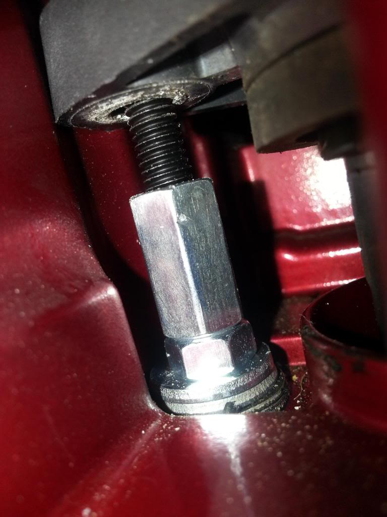

My cop setup and the OE cover bolts on fine
Coils and connectors $35
Wiring and bolts $30
Dont 'ghetto' wire it!!!

I read most of the 20 pages....do civic coils fit under the stock plug cover?
AND
if the yaris coils are too short, which coils are long enough so you dont have to stretch the spring and yet fits under the plug cover still?!!!!!!!!!!!!!
More like 3 pages!! No, they don't.
AND
Yes they do. I posted a photo ^
Old Mar 4, 2013 | 01:46 PM
  #300
Routybouty's Avatar
iTrader: (16)
Joined: Feb 2007
Posts: 347
From: Fort Wayne, IN
Maybe we should specify which coils we're talking about. The ones from the Civic (S2000) 2.0L does not fit. I believe the ones from the 1.7L do fit.
Does not fit:
DENSO Part # 6732301
Believe to fit: (maybe Czarcasm can confirm the part number he used)
DENSO Part # 6732302
I went for the ones from the S2000 (2.0L Civic) because I figured they'd have decent performance.
