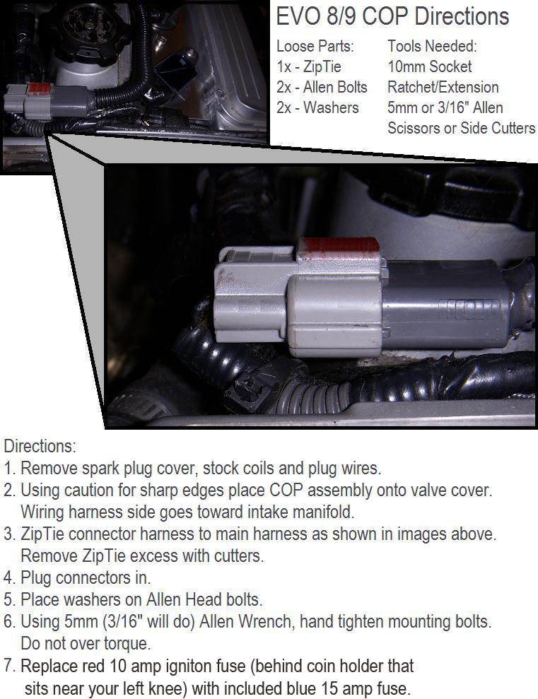

just ordered my parts for this, just want to confirm has everyone upp'd the ignition fuse to 15amps from the original 10 amps as per the spoolinup page http://www.szabaga.com/store/files/directions.jpg

Just noticed on the previous page that the 15 amp fuse is the way to go

have needed to change my fuse does it make any difference?

Use the 15amp fuse and report back.

15A fuse isn't going to change anything, but I would use it over the 10A fuse. Many people have reported the spoolinup blowing 10A fuse and Spoolinup suggests a 15A fuse, as does Sparktech I think
