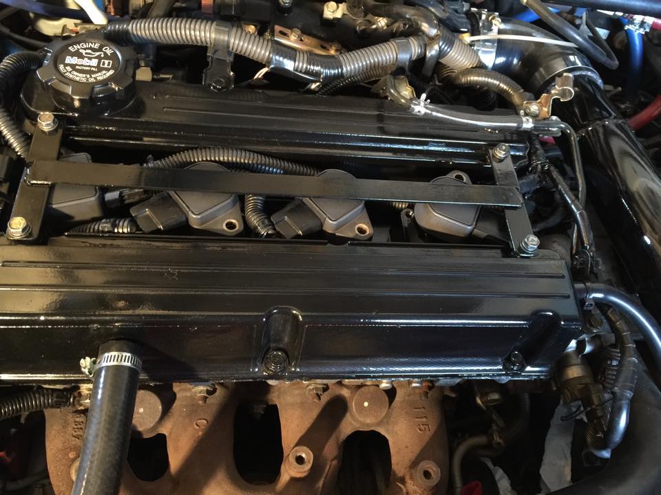

I did the DIY coils with Honda Civic coils from 01+ part number 673-2302 denso part number 099700-070. Brand new they are $130 total shipped.
You have to remove the inner rubber liner on the coil pack so it will actually go over the spark plug.
I had to make a bracket to hold the coils down. I lined it with thin rubber under neath to hopefully keep vibrations from letting the bracket chew into the coil packs. I was able to remove the rubber seal from the coils and silicone it down around the spark plug opening on the valve cover to keep crap out. (It still seals around the coil pack even though it now goes around it at a lower point).
All in all not a real hard mod to do, this thread was helpful, especially with the wiring - the wiring pictures / info / diagrams in this thread was great!
Attaching picture of the setup and the coil packs themselves....

Does it say anywhere in the thread that the existing coil pack holes can be used? I don't think I've ever seen any aftermarket individual coil packs that will bolt up to existing holes and not need some sort of mounting plate
I think your right about it not being in this thread. I'm looking for the thread where I read that now (thinking it wasn't evom?). After actually paying attention to where the stock mounting locations were when taking the stock coils out, I could see that wasn't going to happen- for obvious reasons.

BTW.. just thought I'd mention, you can use the Honda (denso) coils and put your stock cover back over them. You have to rig something up to hold the coils down... in my case it was as simple as silicone-ing some square foam blocks under the stock cover that are about 3/8" thick to hold the coil springs compressed onto the plugs. This makes for a clean setup...
that's a good ghetto (but still good) idea, just make sure you're using foam that wont degrade / melt over time from heat
