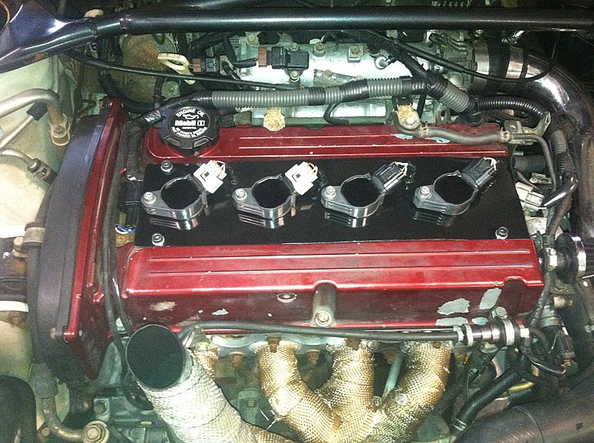

i made my own from scratch with $40 in materials..dont mind the valve cover

^^^where did you get the male connectors that connect to the evo harness? anyone?
You can get them from spoolinup.com
Old Jul 29, 2012 | 10:15 AM
  #209
johnnydemz4G63's Avatar
Joined: Oct 2011
Posts: 117
From: Colorado
Placed order, pics to follow soon.
