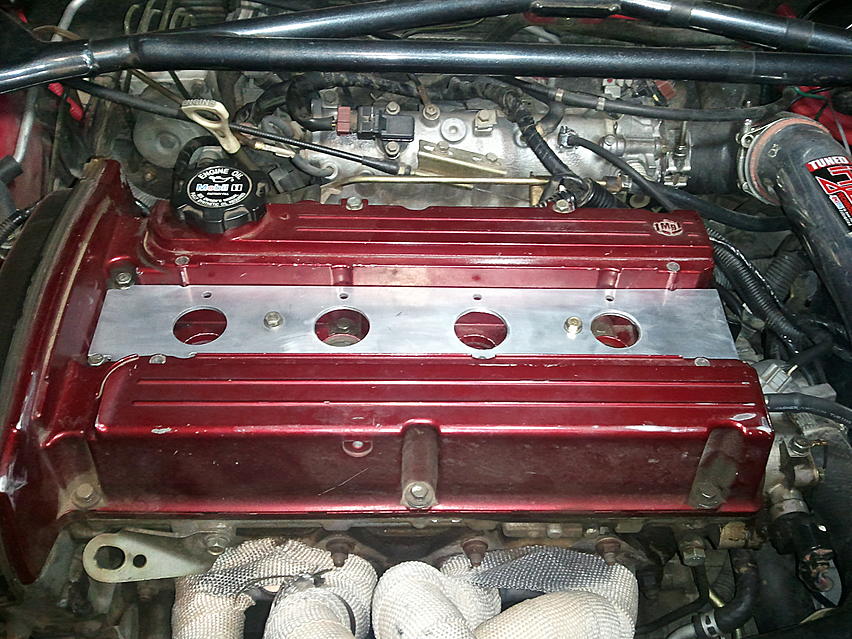

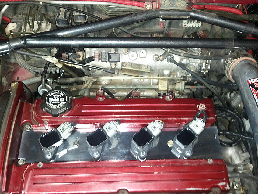

I finished up my custom COP kit this weekend. Making that plate was far and away the most time consuming process, ~ 5 hours, but I'm somewhat of a perfection. I also had to stretch the springs a little, but I also wanted to keep the rubber grommets/spacers. Here was my cost breakdown:
Solara Coils: $69.40
From Spoolinup: Blank AL plate, DIY wire, DIY sleeving, 2 connectors + pins, shipping: $43.50
1" Hole Drill Bit with Pilot Bit: $16.34
Total cost to enjoy the benefits of COP: $129.24
How the car feels and responds now: Priceless!

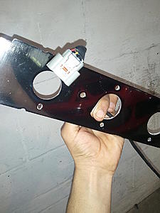

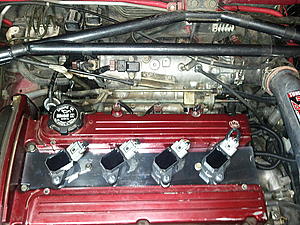

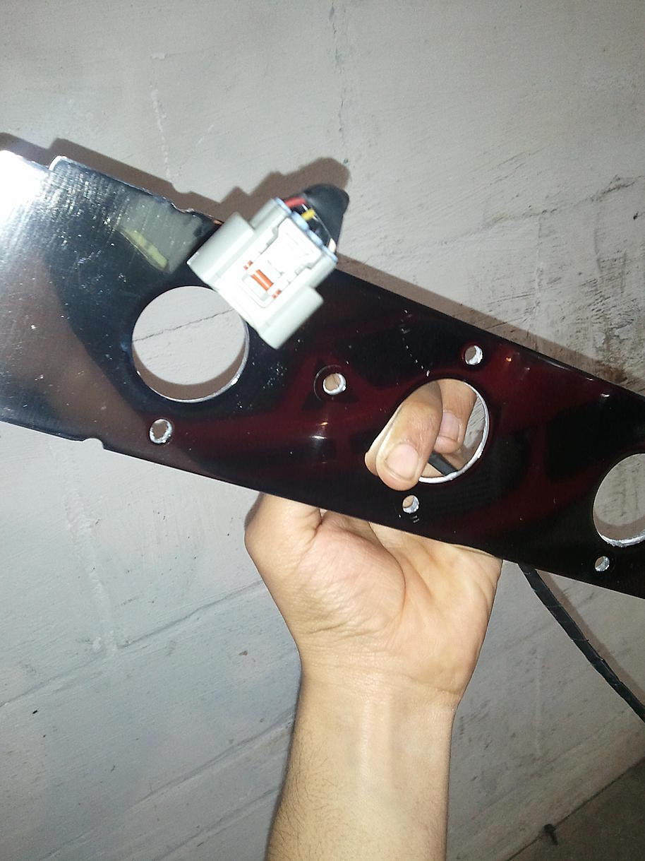

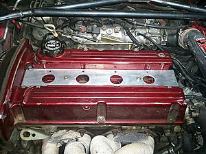

Since I had a little spare time, I attempted a little bit of a wire tuck along with the ignition setup.
Got measurements for the plate, worked on the wire tuck, polished plate, and...
Voila!! My final product! Crappy cell phone pics, but you can see the concept.
Attached Thumbnails How to make cheap coil on plug setup-ign6.jpg   How to make cheap coil on plug setup-wire-tuck.jpg   How to make cheap coil on plug setup-ign1.jpg   How to make cheap coil on plug setup-ign-final.jpg
