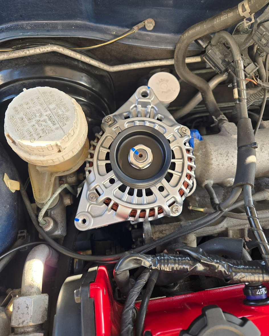

Posting this one for the RHD crew. My car is an Evo 6, so this may only apply to 4/5/6 owners, but it might be helpful for 7/8/9 RHD as well.
I thought this job would be easier on an RHD but it is probably harder - the brake and especially the clutch master cylinders were very much in the way and the hardlines meant doing anything more than nudging them was not happening. Going out from the bottom was not an option because my down pipe is welded to my turbo outlet by rust, so it needed to go out the top.
The 6 (and probably the 4/5) has only one bolt holding the alternator to the brace, and removing the brace is not really an option, but it is not really in the way either.
List of things I removed or loosened to yank the alternator out the top, in no particular order:
- Strut tower bar
- Brake master cylinder (loosening the two bolts holding it to the brake booster allows flexing the lines)
- Power steering line (loosened per above, but I'm not sure how much this really helps)
- Brake booster hose (unclamped from booster and set aside)
- Oil dipstick and tube (unbolt from bracket, turn 180 degrees, and yank out)
- Fuel pressure regulator (remove per above)
- Intake manifold grounding wire (remove the bolt attached to the manifold completely and set aside, if you leave the bolt installed it will get in the way)
You might want to consider loosening the clutch master cylinder. This requires disconnecting the master cylinder from the pedal, loosening the two nuts holding it to the firewall was not enough to loosen it. I did not, but by that point I had bashed the bejesus out of my brake and clutch hardlines and I figured I wasn't going to do any more damage to them by just yanking the damn thing out.
The serpentine belt does not have enough room to be removed from the alternator until the alt itself is unbolted, so go ahead and take the belt off the crank pulley to remove tension from the belt completely.
Pic below is how my alternator came out and how the new one (pictured) went in:
Honestly it was a big PITA. If you have to raise your engine for the timing belt service and your alternator is older than 5 years, I'd just replace it then like the water pump.
- Strut tower bar
Going through the bottom is 10x worse, IMO.
Also, I agree on swapping the alternator, if you can find OEM. Otherwise, I would never pull the OEM alternator unless it failed. Once you go aftermarket, you will be swapping them, on the regular.
