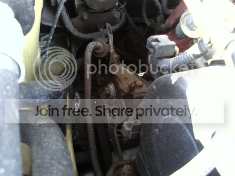

I broke mine when my alternator died and haven't replaced it. Use a pry bar to get the alternator where you want it and tighten the bolt on top. My alternator has been like that for months. I'll try to get you a picture.

Here we go...
Notice the bracket the bolt is going through. That's the bracket that dictates how much pressure you want to apply on the belt. Use a pry bar to apply the wanted pressure, and secure it in place tightning the bolt.
