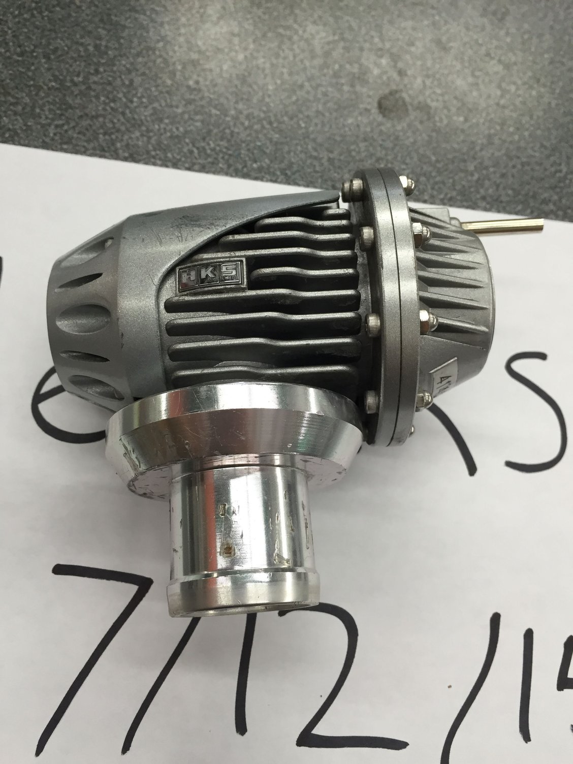

Old Jul 26, 2015 | 10:07 AM
Evo MR IX Fritz's Avatar
Joined: Aug 2011
Posts: 142
From: right neer daaa beach boyyyy
Old Sep 27, 2015 | 01:57 AM
blknblubkrdude's Avatar
iTrader: (16)
Joined: Feb 2010
Posts: 681
From: Gillette, WY
Nicely done thread! Should help a bunch if I get this kit.
Any issues so far? Use the internal BOV yet?
