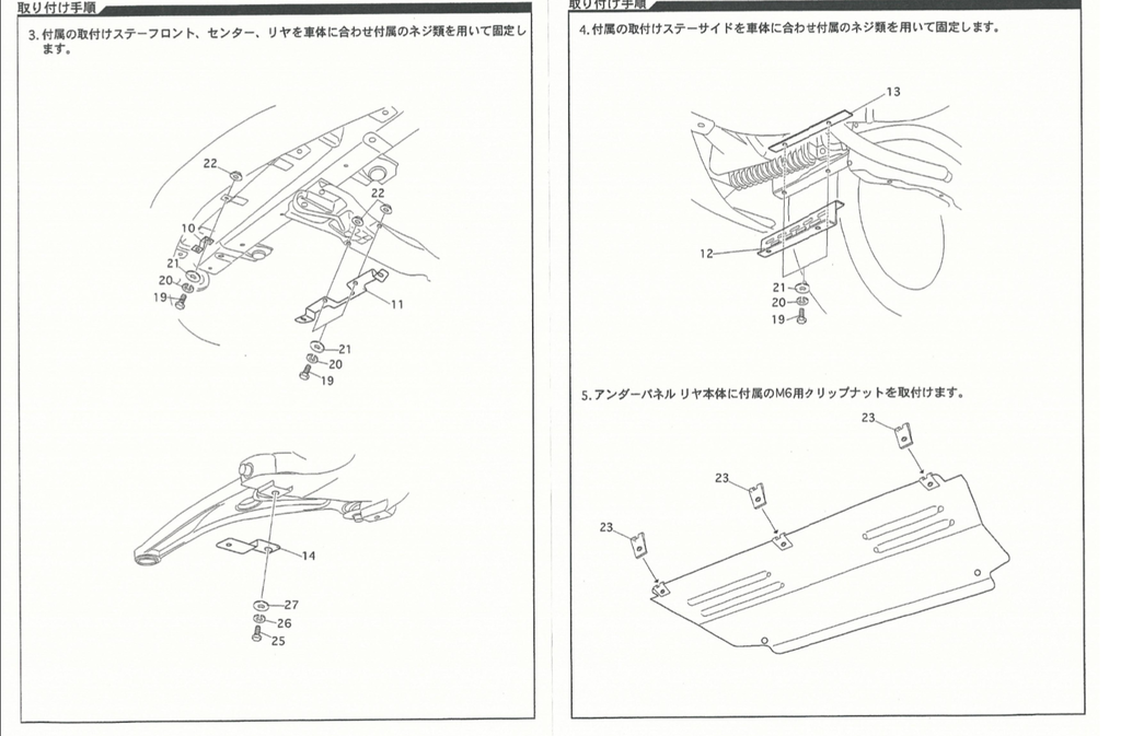

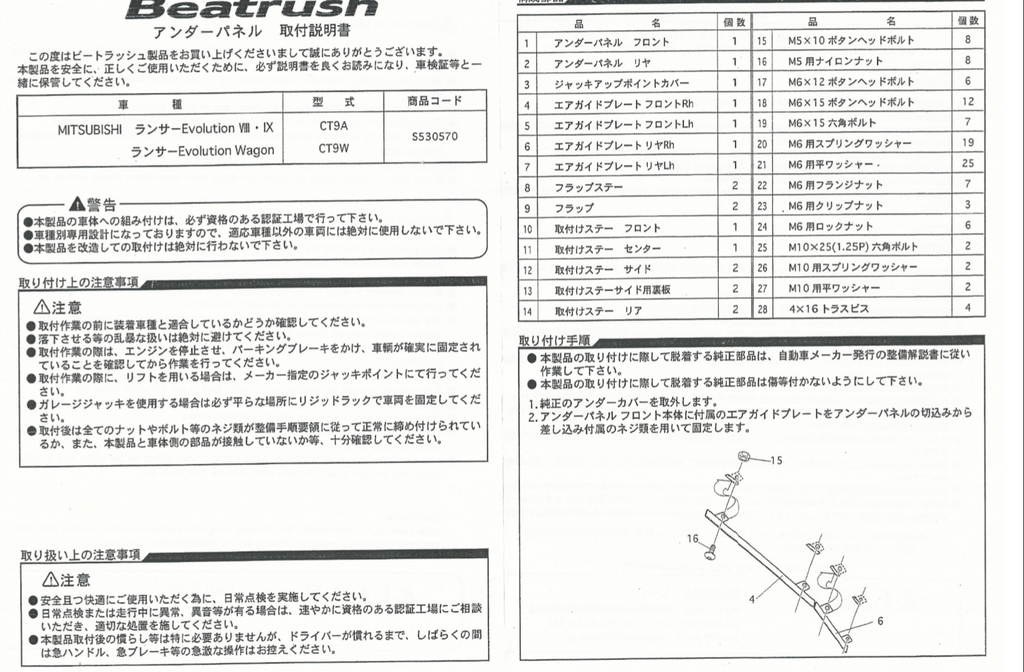

How to Install Beatrush Front Undertray
This is the instruction manual for the install. Hope this helps out whoever loses the instructions and needs to order replacement parts. I will upload more pictures of all the parts included later.
