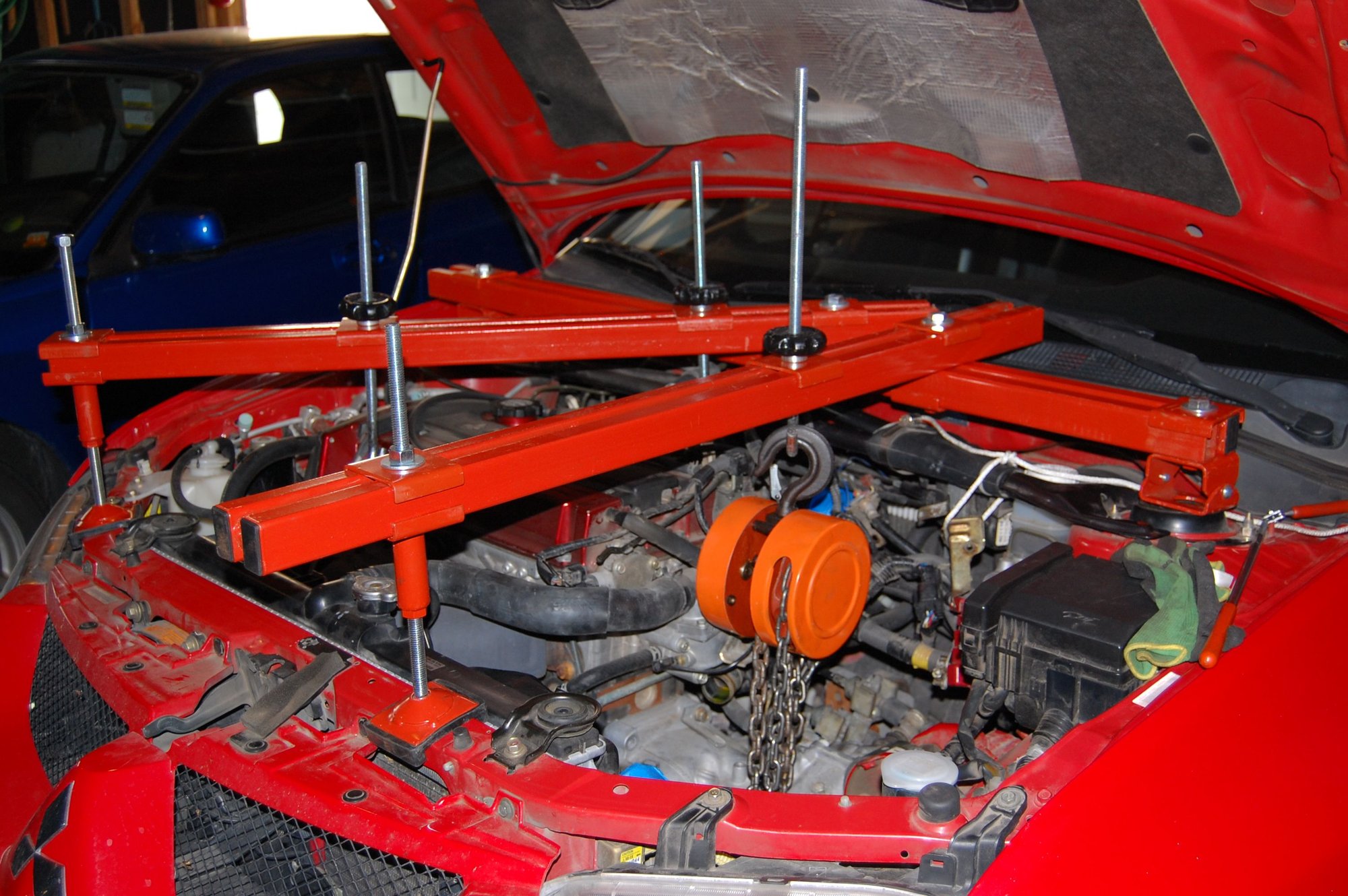

An old picture of my engine hanger and hoist.
Knowing the center of gravity (its at the hole in the bracket on the shifter mechanism) and connecting there causes the transmission to hang level. Using this little hoist I can raise and lower the transmission with no effort. I'll be 71 in June, I think my transmission bench pressing days are behind me.

Wow, that engine hanger is a beast! 71 in June you say? Much Respect. There are not many people who can still do this at that age.

where did you get that sweet engine support?
Old Jul 29, 2019 | 08:39 PM
Fsae_Alum's Avatar
Joined: Dec 2007
Posts: 138
Likes: 31
From: San Diego
I bought mine from Best Buy Auto Equipment. It's a Norco 78099
https://www.bestbuyautoequipment.com...orco-78099.htm
It does not come with the chain hoist. You'll have to search to find the smallest chain hoist you can get.
