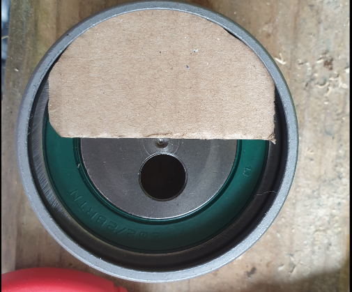

Start by making a rough cardboard outline of your tool:
Trace it on a piece of steel:

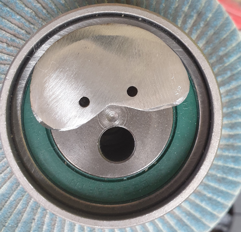

I already drilled my holes for the pins.
The holes should be ~13mm apart

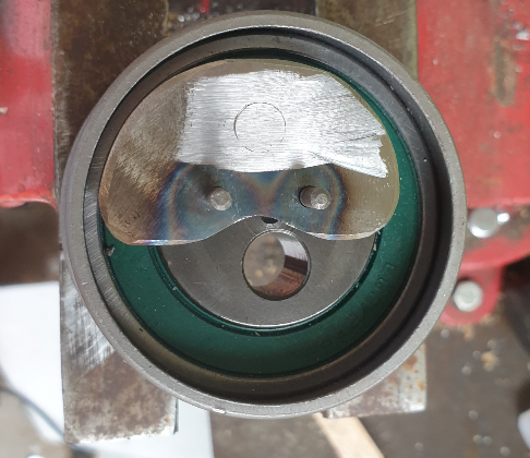

Grind a relief for the tensioner bolt.
and after some cleanup and grinding it to correct size:

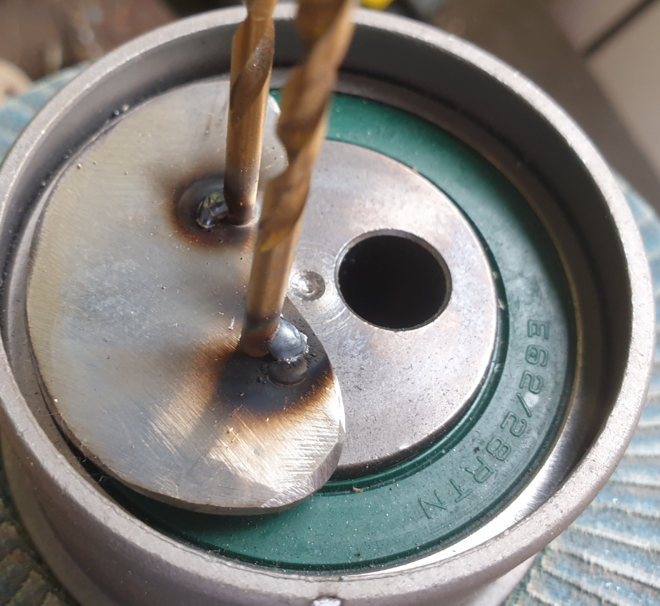

Tack your pins in the holes
Note that you don't have to weld them if you don't have a welder. All you have to do is get them to stay in place with epoxy/whatever
Cut the pins flat, add some weld and grind them a bit nicer:
again you can just use epoxy or something if you don't have a welder.

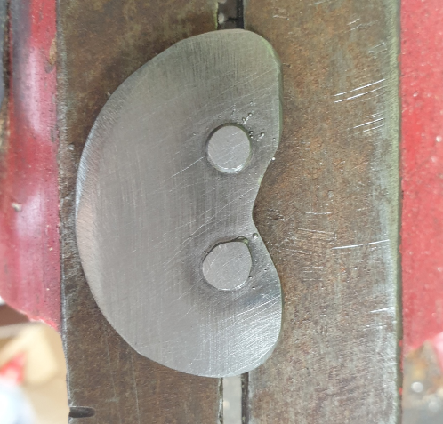

For the tension nut/bolt you can either weld a nut in there or do what I did and drill and tap a bolt in there:
and from the other side:
Here are the final dimensions of my tool with some beautiful ms paint:
The pins protrude ~6mm on the other side.
