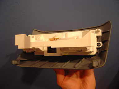

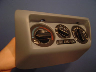

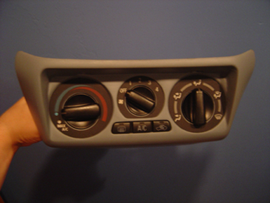

Original Version
Newer, Redesigned Version

Move the climate control down into the cubby? Is that what that is and how you did that?
Old Apr 21, 2005 | 08:29 PM
vtecTHIS's Avatar
Posts: 431
From: i can't speel or tyep
hmmm
Old Apr 21, 2005 | 08:31 PM
spoolingEVOx's Avatar
Posts: 674
From: Jersey, USA
yes. i used a 3rd generation eclipse HVAC unit with an oem radio relocation kit down below. my installer matched the harness from the 3G eclipse to the EVO (serious PITA to do) and did some custom fabrication to make it fit as if it were factory.
up top, i used an oem UK-SPEC 2-DIN dash panel that i obtained through my motorsport company with the oem pocket and infinity headunit. i have a jdm metallic-look overlay on order to match the console.
like i said in my first post, the next step is an eclipse AVN system. defi amber BF auxilliary gauges will be mounted on the pillar via a lotek 60mm triple gauge mount.
btw.. am i the first to do this?
