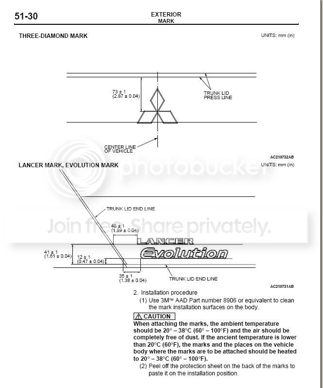

I had my trunk replaced after vandals stole my wing (destroying both the trunk and the wing in the process) and decided to just have an RS trunk put on in its place. That said, I need to put the Mitsubishi emblem and the Lancer emblem back onto the trunk (and I'll be tossing on the UK badge as well).
Can someone who has an Evo take a couple measurements for me? I need...
1. How far down is the Mitsubishi Emblem?
2. How far up is is to the bottom of the Lancer badge and
3. How far in from the bottom corner of the trunk is the left side of the Lancer badge?

hope this helps.......http://www.joe250.com/cars/evo/badgeremoval.htm
Old May 5, 2006 | 11:37 AM
evo150's Avatar
iTrader: (51)
Posts: 1,981
From: cincinnati
sorry about that, you are trying to put the mitsu emblem on. i just measured for you its 1 1/4 inch from the top of the decklid. dont know about the lancer badge though (i debadged mine)

Old May 5, 2006 | 01:14 PM
EvoGLH's Avatar
Joined: Nov 2003
Posts: 131
From: SE Mich
This should help.
