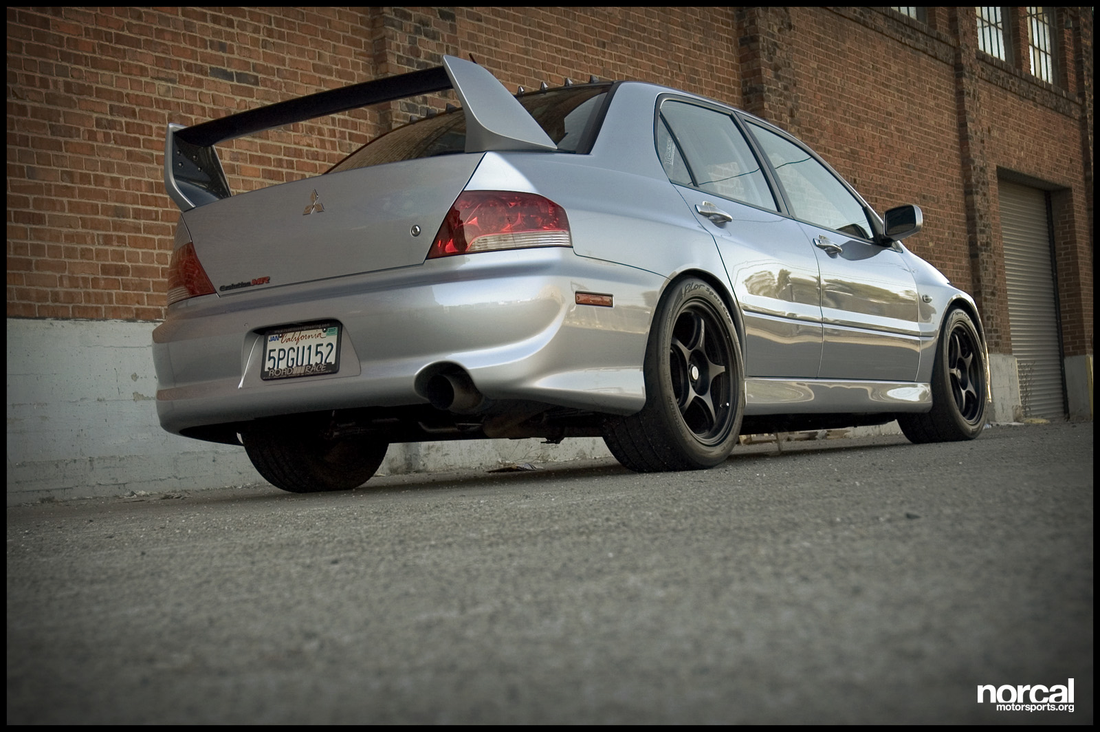

Originally Posted by razorlab
If you push too hard on the fender it will cause warping of the fender. I did that on my car a little bit. You can only see it in certain lighting however.
You can see it in this photo a little:
http://www.norcalmotorsports.org/use...o062406_02.jpg
This will fit 275's no problem though.
Thanks everyone for explaining the warping. I thought you guys were talking about the tire rubbing the inside of the fenderwell and causing the fender to warp and I didn't see how that could happen.
Razorlab, in your picture, if you draw a line from the "O" in Pilot on the tire up to the rear of the door handle, is that where the crease is? Also, is your passenger rear door dented? The reflections look a little wavy like there are a couple dents?
The rear fenders certainly are a tricky area to mess with. The spot welds that join the inner fender liner to the outer quarter panel can cause creasing of the lip area when you try to fold that area up. It doesn't want to move the same as the rest of the lip.
Yup. You can roll and pull without that happening. It happened to me because I got a little greedy and also rushed the job a tad.
There is a little door ding but other than that no. In certain light all evos look a little ripply right where the fender starts to flare on the rear door.
