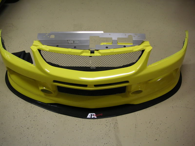

Originally Posted by evoiao
se lip....but the under tray fit so the holes line with that?
line it up with the bumper off the car then drill on the holes of the SE lip

if your SE lip did not come with your evo...you are missing to brackets that are needed to mate the SE lip to the APR splitter.
part # - 6512a151
part # - 6512a152
They are needed to reuse the stock undertray with the SE lip. They rivet to the lip and have mounting holes for the undetray. They are also needed for use with an APR windsplitter unless you want to drill holes.
