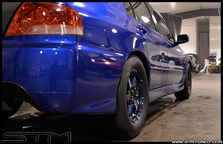

Old Jan 26, 2011 | 03:26 PM
  #148
4g63girl's Avatar
iTrader: (22)
Joined: Jun 2005
Posts: 863
From: Rochester, NY
Finally got her back on the ground for a bath.
Sometimes I forget how awesome it is. The paint is like glass. No divits or ships or dings. Glass. I love this car.
