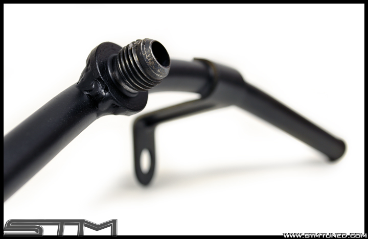

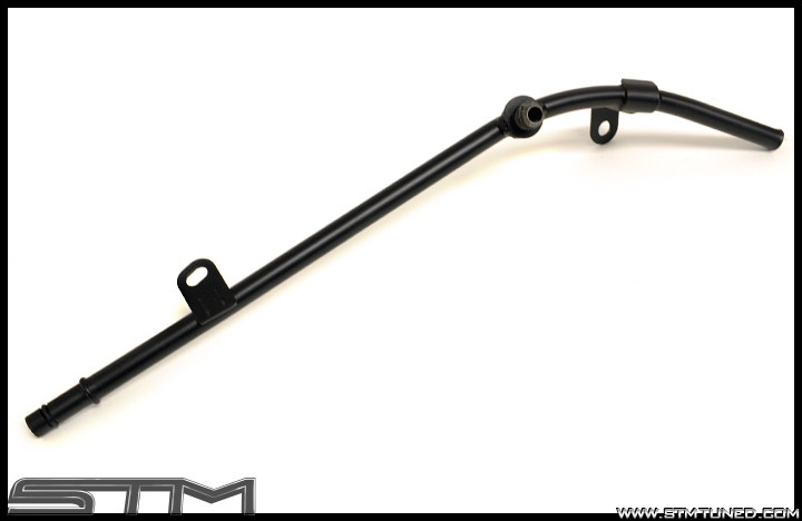

Here's a couple pictures of the oil dipstick

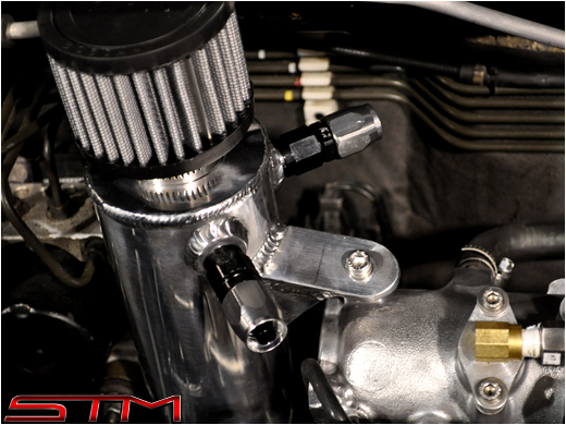

A catch can kit would be awesome.. using those -6 VC fittings you guys have.
Originally Posted by Pirana
That would be cool. For now I need a catchcan with the -6AN fittings
This is not for Ricer, but if you're interested, we just released this kit:
More here: http://www.streettunedmotorsports.co..._catch_can.htm

So, not sure if I'm having a brain fart or what...but Emery, please explain the AN fitting on the dipstick idea...Is it just so you can recirculate the oil that comes out of the valve cover ports??
its to releave pressure in the block. what oil gets blown up the dipstick will be drained back into the oil pan so you dont have to empty a can.
I saw that on your website a couple days ago, looks good! So with this setup, you would just cap off the fittings on the maf pipe & cap off the fitting on the intake manifold. I read so many different ways of setting up catch cans, some people say like this and others say you need a vacuum source like the intake manifold fitting or the maf pipe. And then it depends if you are running a speed density setup or a maf setup, where essentially a vented catch can is a "vacuum leak". ahhhhh!!
So the an fitting on the dipstick will have a line going straight to an fitting welded onto the oil pan or into the balance shaft hole?
i dont know how STM will set it up. but most of these designs go's from the dipstick to the catch can. have you ever heard of some guys blowing off dipsticks and oil everywhere? this will eliminate that issue as well. it lets that pressure go some where ''into a vented can'' and what oil follows will be drained back into the oil pan

The dipstick vent is better than any vent you could have on your valve (of equal size) cover for more than one reason.
1. Venting the block is better than the head as it will allow your oil to return to the pan faster. The air that vents out of the valve cover rushes up from the block through the oil return passages causing the returning oil to slow down and sometime push back up into the head leaving the pan dry.
2. If you have a catch can with a drain on the bottom and it sits higher than this fitting on the dip stick tube you can use the fitting to vent and drain oil back from the catch can.
Just a couple examples of what this can be used for.
