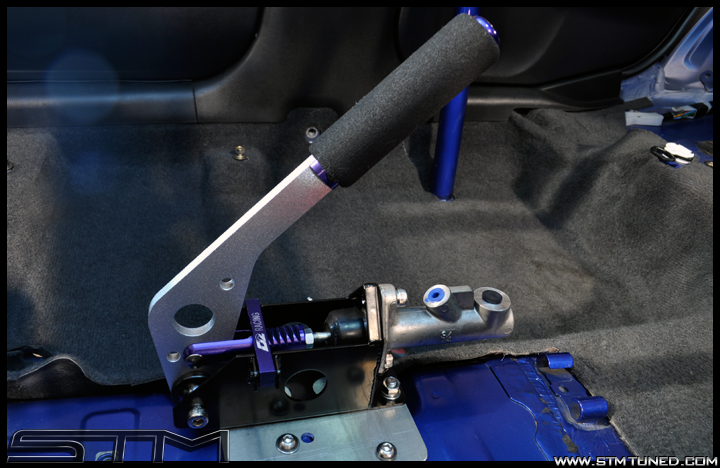

Staging Brake:

Originally Posted by 4g63girl
Staging Brake:
I was actual just looking at these today on their website! So sweet! One of the Cleanest cars I have EVER seen, time and time again! Keep up the great work!

im curious as how you are gonna mod this to make all four lock up for launching as this is something i was interested in doing this winter
You don't need it to lock up all 4. Most people just have it lock up the rears. You just need to pre-load the drivetrain, and as long as you can hold back 2 wheels, it should be enough to keep the car planted while you slip the clutch, and put pressure on everything.
If you plan to 60ft the car in the 1.3's consistently and not do FWD burnouts you need to lock all four.. Trust me..

Most setups I have seen lock a front and a rear diagonally.

I will let you guys know how well it works once we know. If it comes out good we will be building a kit and selling it.
