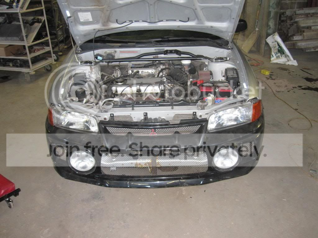

Old Mar 28, 2011 | 02:47 PM
  #68
Alchem1st's Avatar
Joined: Sep 2009
Posts: 243
From: Indianapolis
Test fitted the Evo front today! Someday it'll go on...
Bit of a gap here:
OM NOM NOM I WILL EAT YOUR CHILDREN.
Those JDM headlights are killer bright too, here's the best I could do with the hibeams on LOL:
Also, got my Evo 8 mustache bar and diff hanger in so I built a bit of the rear end:
