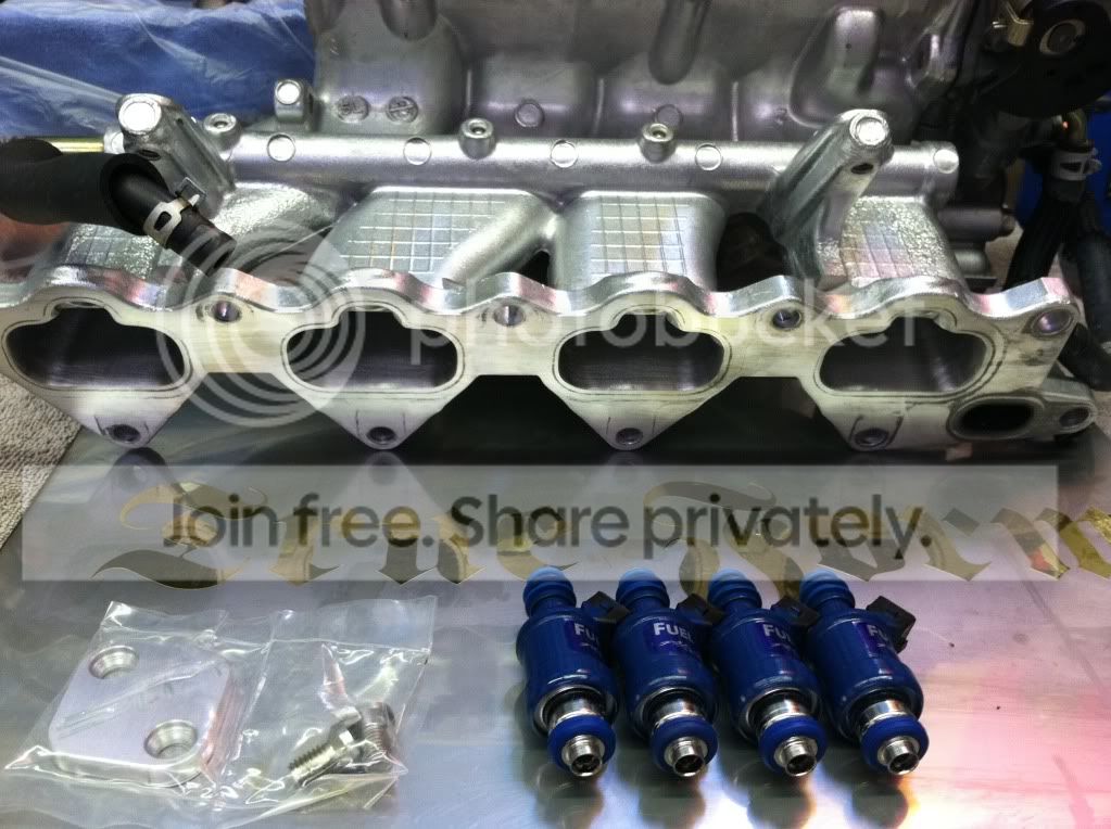

So today I got around to replacing the seals on my Brembos. My right front is almost black no longer brown and upon pad inspection after last track event I noticed un-even wear on the pads. My only thought was a dragging piston. Upon inspection 2 of my pistons (outside passenger) have the teflon esc coating wearing off and very rough. This could be the issue I think. Anyone else seen to this problem?
I have never had any bias issues on track but the right caliper is def. getting worked more.
On a good note I got everything for the Intake Manifold installed.
FIC 1450's, STM EGR delete, Ported IM

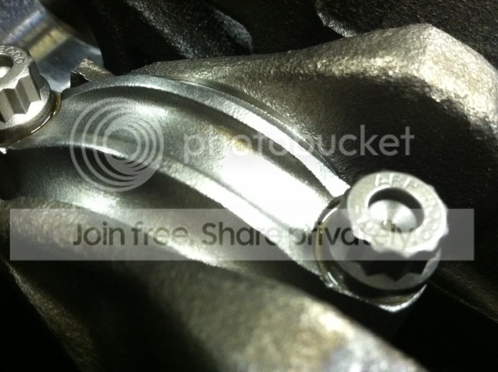

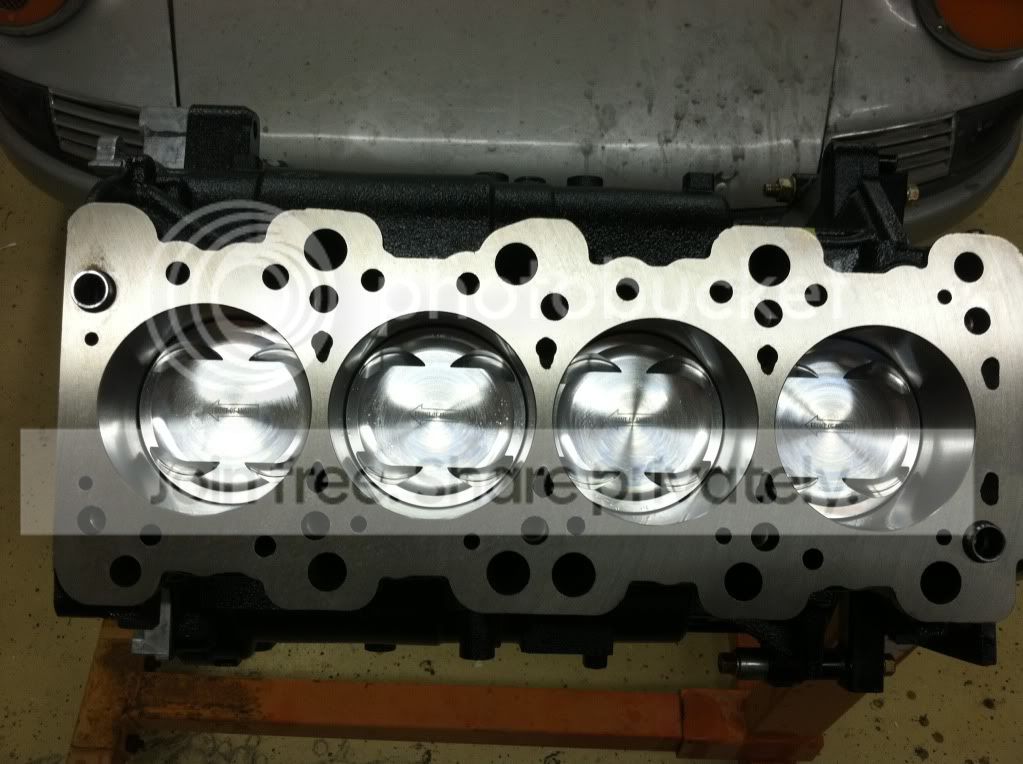

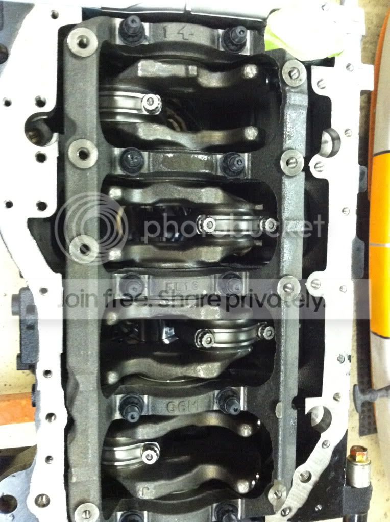

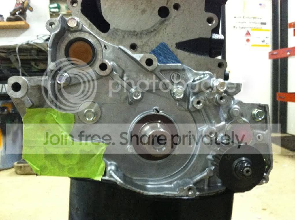

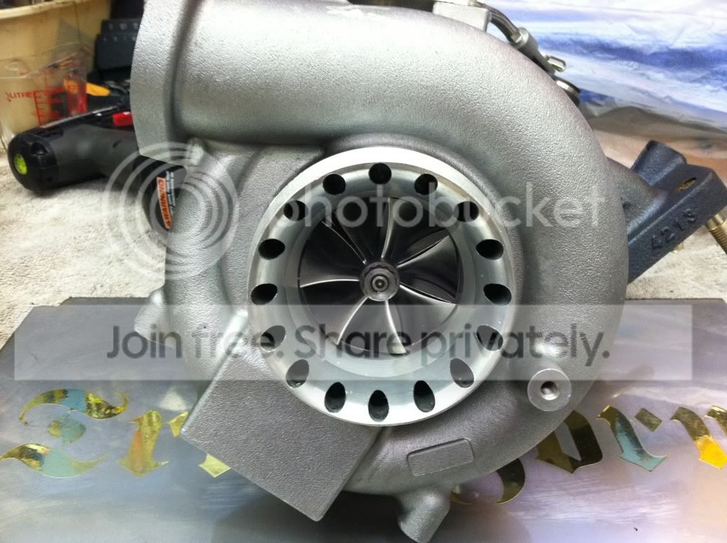

UPS man came today!
New oil pump + balance shaft delete.
Manley Rods and Pistons
ARP goodness
EF3 Turbo with 3 inch anti surge housing.
