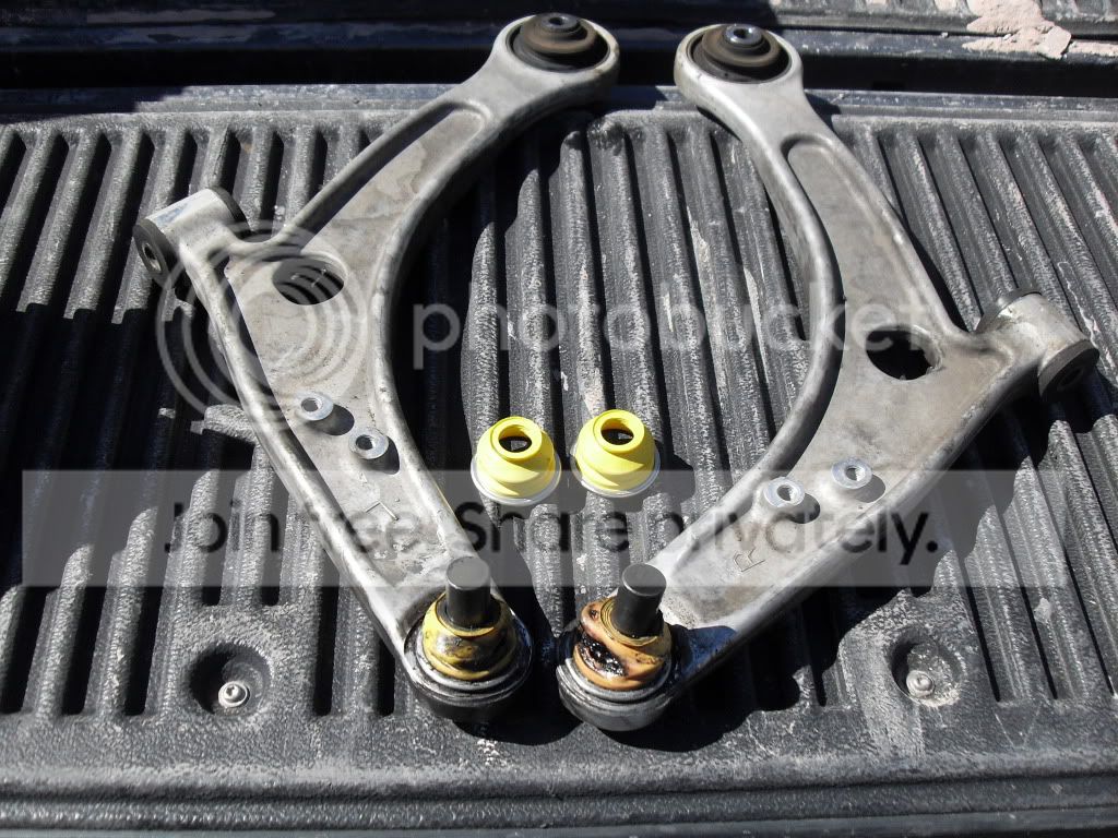

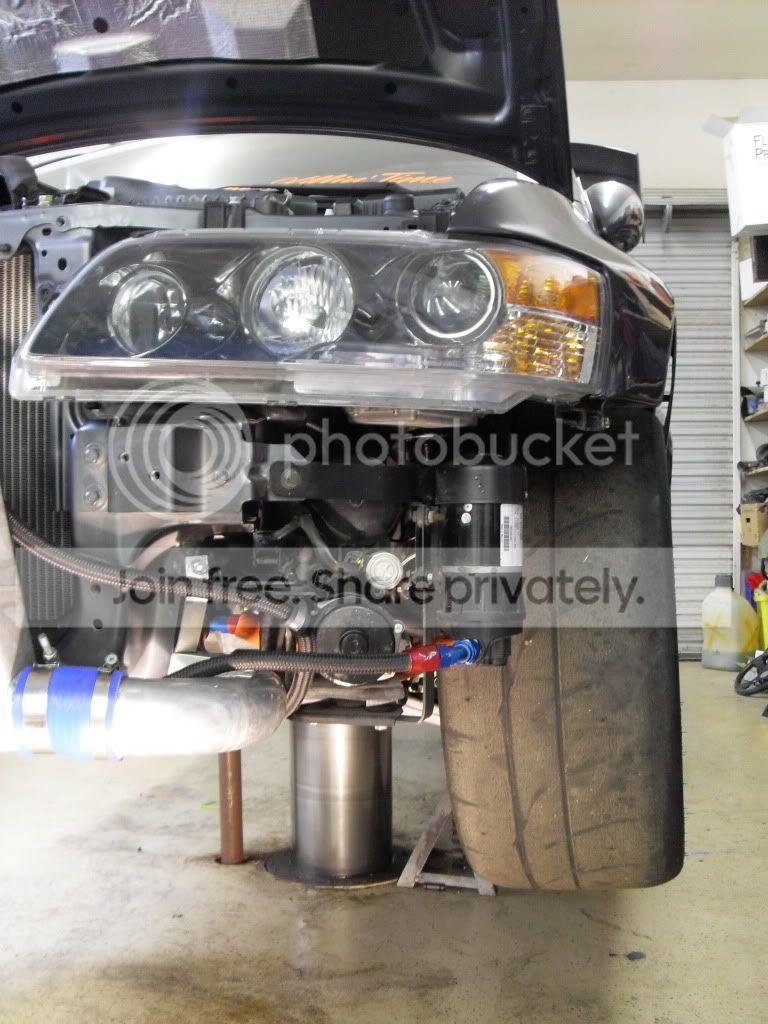

Both of my rubber whiteline boots were trashed so I replaced them.

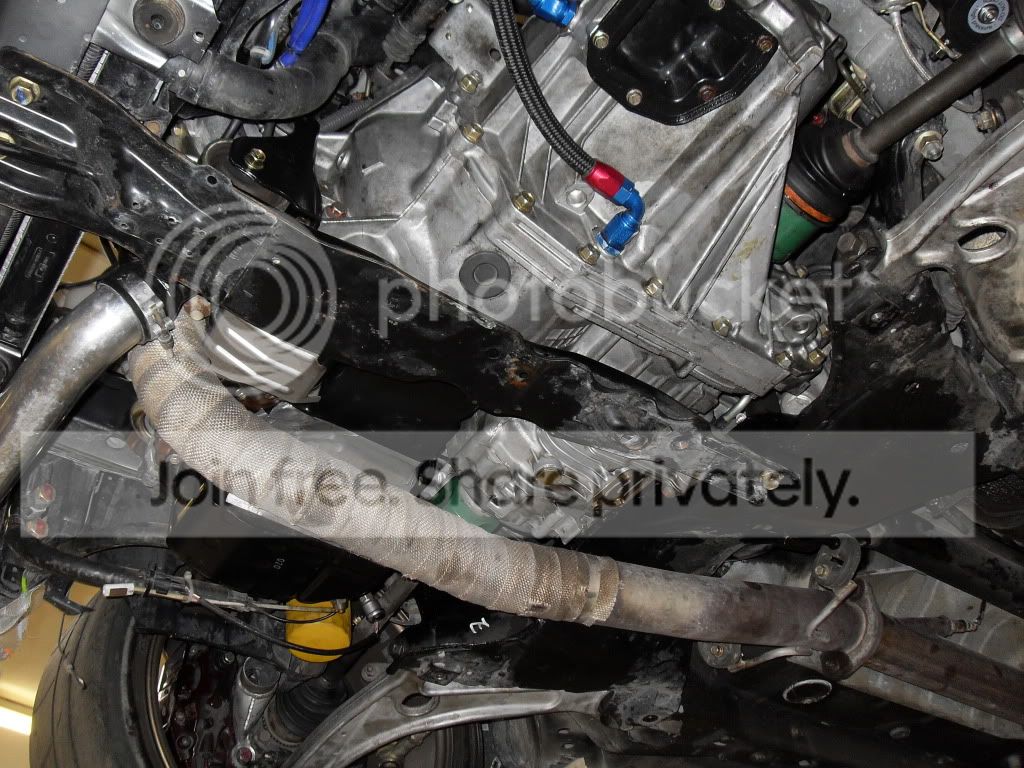

Underside pic of the tranny all buttoned up. I had to modify one of my AN cooler lines with a new 90* elbow due to the new 5 speed fill hole.

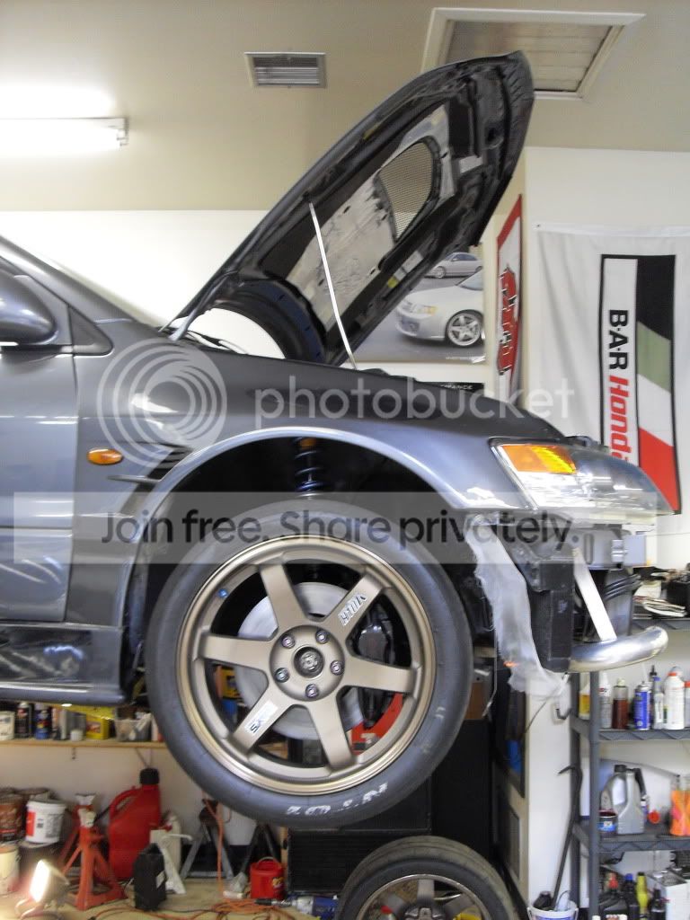

Alot of static camber.....

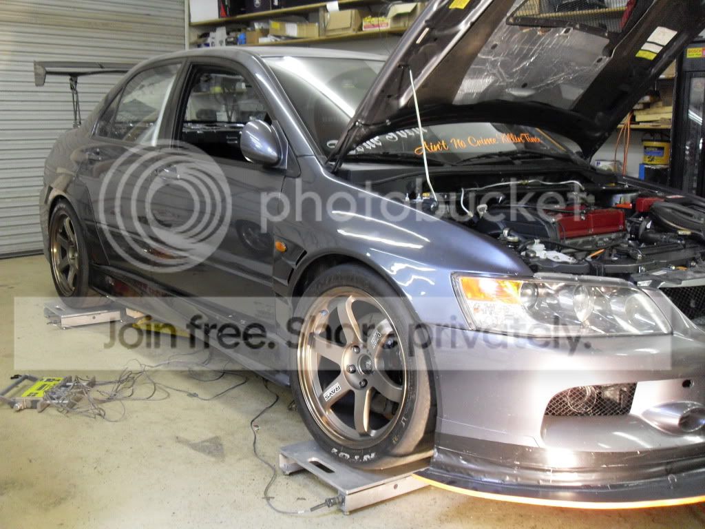

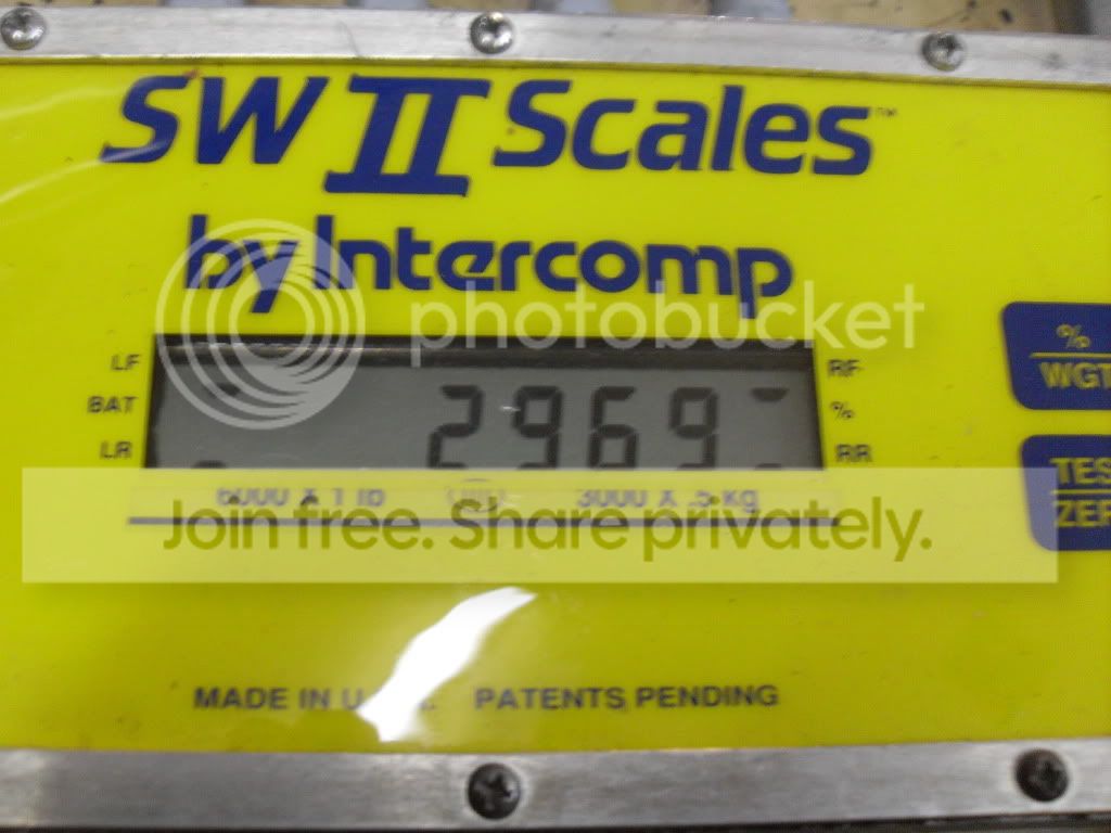

Put it on the scales and corner balanced the girl.
I meet my weight goal! Sub 3000 lbs with a little less than a 1/2 tank. I still have a few weight saving Ideas.

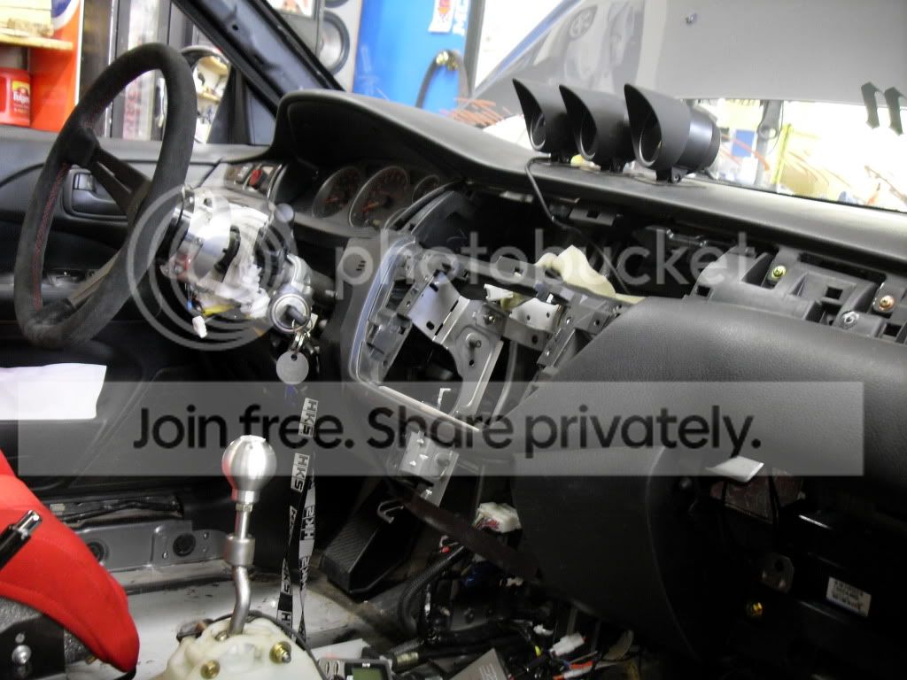

Still working on my wiring inside. I am having a few issues with my gauges.

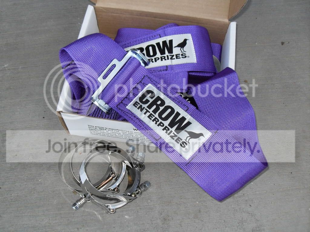

Purple Nurple and some new T-bolt clamps came in today
Obnoxious

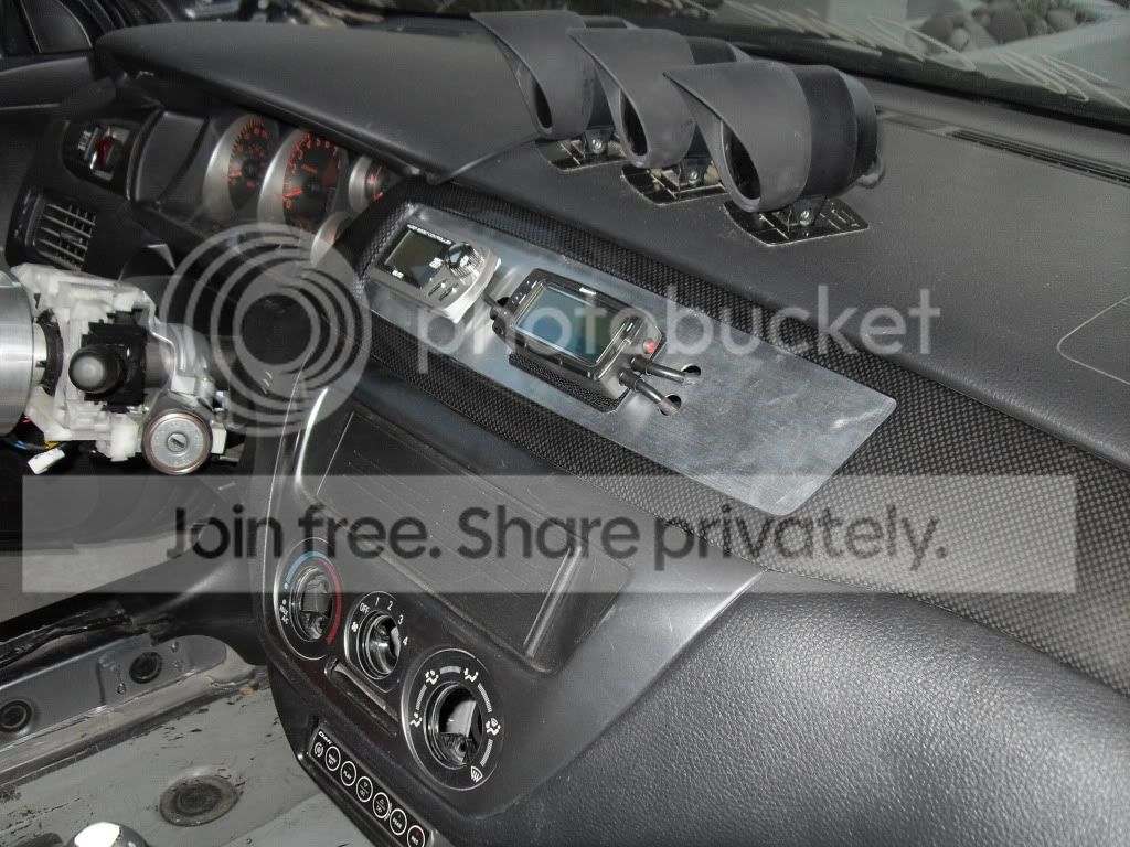

Finally finished up all my wiring in the car and made my new bezel for the Boost Controller and Timer
