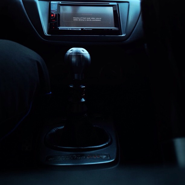

I bought one of these. They are awesome. I will load a better picture of the actual kit during the day, but I've had it installed for 3 months now. One thing though my hvac lights don't work on one side and some times not at all. Anyone see that before? Ima check the bulbs I just never got around to it.
Attached Thumbnails New headunit/hvac set up!-image.jpg
Old Jan 12, 2014 | 04:11 AM
  #192
cyanide's Avatar
Posts: 144
From: Sunny Puerto Rico
Hi. If it's only half the bulbs that are turning on, you should check your fuses first. I had this happen with both Lancers I had, 02 and 05, and it was a blown fuse, but I don't remember which one. Turn your lights on and check the rest of your bulbs. If it's the fuse, there should be other bulbs also off outside. The fuse should be from the engine compartment box, but check both just in case.
If all fuses are good, then you'll need to test by swapping the working bulbs to the non working side.
Hope this helps.
