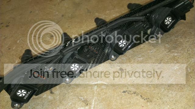

Spoolinup coil on plugs
Uses Toyota COP and can be used with stock ecu. Better ignitions!
