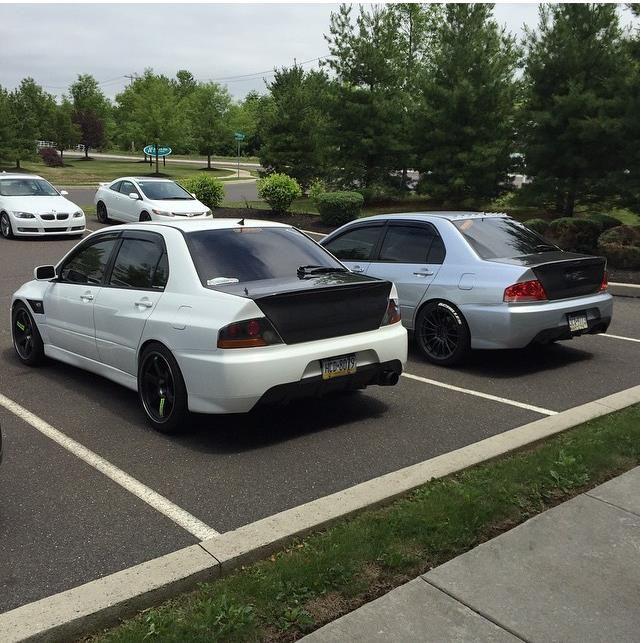

I have TE37 18x9.5 +22 and i run a 265/35 tire and I do not rub at all. It just takes a lot of work. Stock body all i did was roll the rears and they arent even rolled flat.
My Buddy on the right in the picture is running Enkei RS05RR and they are 18x9.5 +22 with the same 265/35 tires and only rolled.
